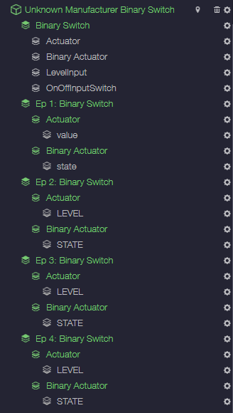

That a side, i need help to make it update currecly in Zipato - both Fibaro HC2, and the Vera Edge has the possibility to read the manuel status, it work if I turn it on/off in Zipato - but when pressing the manuel off botton, it stays on in Zipato. The manufactory told me i need to make sure Zipato supports Multi Channel devices, + i need to be able to make bindings on master and slave notes. Whaaatt :)
HC2 guide in danish, but with pictures.
https://youcontrol.dk/media/wysiwyg/Vejledning_ZHC5010_-_Fibaro_Home_Center.pdf
The danish guide, with pictures could maybe help some in gessing, what needs to be done in Zipato, hope someone will help, if not Zipato will find the device absolutly fantastic and include and support it via a future firmware update. It goes ind as a "Unknown Manufacturer Binary Switch."

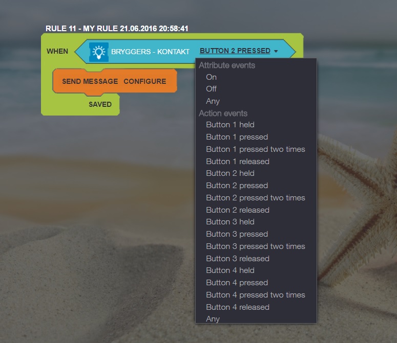

Hi Troels, if you update to latest beta 1.0.13 and exclude & include the device again, under devices under control you will now get new options to use all the bottons - see my picture.
I have tested it, and it works - no delay on the action of the rules! :0)

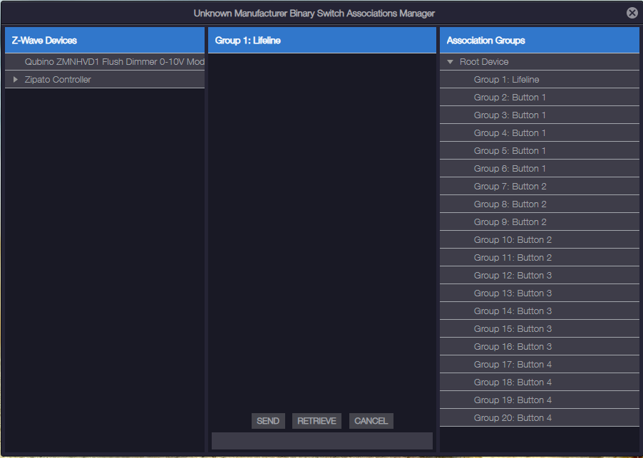

ZHC5010 only has one relay and that's exactly what you see in the device browser. The rest of the functionality is available via the rule creator.
To get relay state updates the controller needs to be associated with ZHC5010 association group 2. You can use the associations manager to check this.
