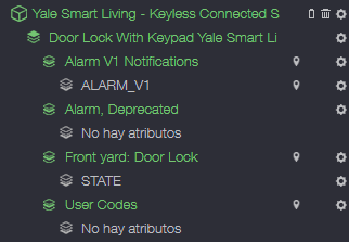

This is what I see in Device Manager:
/f8588acdb8c6dd3547f194288a805ddb
In devices explorer (or browser, don't know how it is in English), I have one "Door lock" called "Front yard: Door lock", and one "Keypad" called "User codes". None of them shows any event, but I can see events under "ALARM_V1" in "device manager", but those events are not listened on Rule Creator (since the Device ALARM_V1 is not shown); they are not listened niether by the Alarm "Intruder", where under my user I chosed the device under my user, and entablished "Dario HOME" under the "Disarm" property.
My Device has 1 endpoint, which has 4 clusters. The only place where i noted that there is a log of every time the lock changes its state, is the attribute "ALARM_V1" of the "Alarm V1 Notifications" cluster.
In devices browser I have one "Door lock" called "Front yard: Door lock", and one "Keypad" called "User codes". Those are, obviously, the clusters 3 and 4 from the list above. I don't know how to read the events from cluster 1 to disarm my alarm, directly or executing a rule.
I cannot find the way to get the events from attribute "ALARM_V1" on Rule Creator (since ALARM_V1 is not shown as a device, nor as an attribute of the endpoint). Those events are not listened niether by the Alarm "Intruder", in which under my User, I chosed the proper device and entablished "Dario HOME" under the "Disarm" property.
What am I doing bad? Thanks a lot.

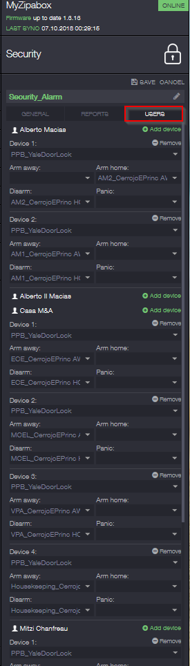

@Dario,
Right now looks like we have lost that functionality, so even if you configure the user codes, nothing will happen. I opened a ticket on zipato support, first they told me they would help me debug the issue but because I was out on a business trip we could't work on it. When I came back I wrote and they came back saying they were now busy and that they would need a unit to make tests and that seemed I was the only one with this issue.
My email is alberto.maciasp@outlook.com if you want to discuss further. But basically, the codes you add directly on the lock won't be shown in Zipato Box, only the ones you add from Zipato UI. Then you need to go to configuration of your virtual alarm and add these events to quick arm / disarm your alarm.
