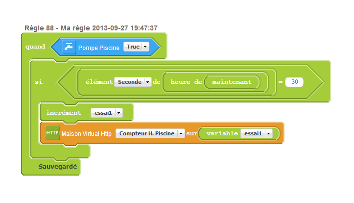

i would like to make some hour counters to watch my swimming pool pumps.
I try with rules but nothing work.
Have you an idea ?
THanks

it's a example of a rule i try to make my counter.
Of course it's no good.
Thanks for your help

Try this:
When >> Scheduler (Repeat >> hour - repeat every: 1 - never ends) then rest of rule.

Super
It works. I repeat every 10 minutes en after i made a rule to have the hours.
Thanks a lot
