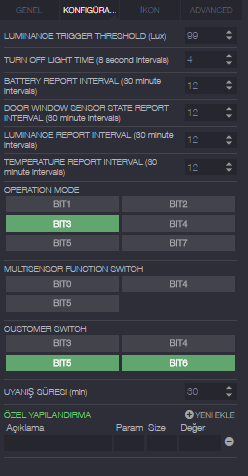

you need to change the luminance report interval to 1. THen you can either just hide the other meters via the device list, or change the bit value in the multisensor function. You will need to consult the manual to see which setting will do luminance only.

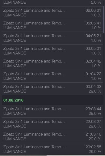

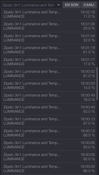

This rule don't has to temperature or humidity. It use to only luminance value. If I don't use the values, this method will earn me more energy. But whatever I did, I can't measure any value without motion sensor. If no motion, it doesn't measure any value.
The values in file is not true :( If the trio sensor perceive a motion, It shows true values.

Values with motion and values with no motion

If I understand you correctly, the issue is that changes in illumination (luminance values) aren't sent to the Zipabox as often as you like. For this you need to change the report interval from the device, if possible, and set it to report however often you like. Be aware though, that constant reporting drains the battery.
As far as I understand, the "Refresh All" block in "Advanced" section will interrogate all devices and ask for their values. This too, done too often, would drain batteries. After you issue a Refresh All, you'll probably want to wait a few seconds before you test values.
