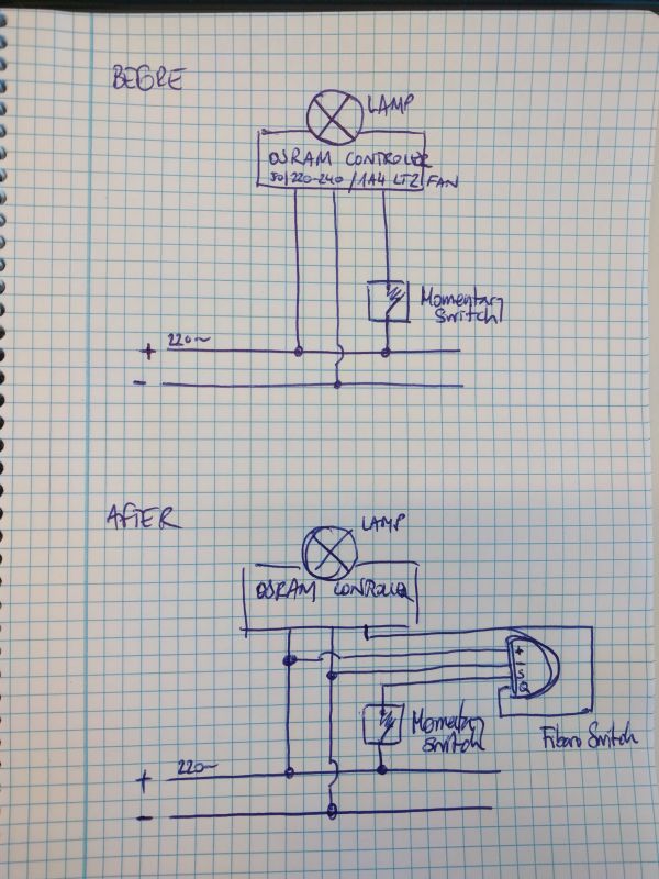

It can be DALI-controlled or momentary switch controlled. My lamp before z-waving it is controlled via momentary switch: If you push it and release, lamp goes on. If you push it again, it goesoff. If you push and hold, intensity goes up until you release it. Push andhold, intensity goes down until you release it. Let say it is controlled by a pulse, which lenght is variable.
In the attachment is the electrical wiring for BEFORE, when lamp was working properly. AFTER the z-waving it, I managed it to work properly with the fisical switch, but not with the app.

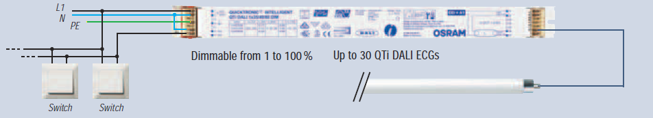

My lamp also has Touch DALI controler for T16 fluorescent lamp, but control logic is exactly the same as you described. Connection diagram in attachment. I'm looking for solution for z-waveing, for now only thing that might be working with touch DALI is Fortrezz Mimolite I/O module:

Yes this issue is that you can not send a "timed" press of a button in the Zipato app. Dimming as you are trying to do is done directly by a z-wave dimmer module in most cases, not via another electronic dimmer. Basically if you were to use the mini energy dimmer or fibaro dimmer, they would replace the dali/osram dimmer you are currently using.
Currently the only way I can see how to control via the dali dimmer is with the inbuilt relays in the Zipatile. These you can set up with the touch buttons on the zipatile for closing the contact on touch and opening on release. But no buttons in the app support this.
You could alternatively, and this would be a big work around, create a virtual dimmer, that via rules actives the fibaro module for xx number of seconds depending on what the value of the dimmer is. For example, you set the dimmer to 50%, the rule states that when this dimmer is activated, turn on the fibaro module for 5 seconds then turn it off. You could create a formula to process the variables to make this easier and quicker, or use a range instead of just a set percentage.
