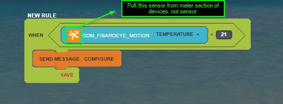

I don't know why even the "Temperature" option is selectable on a SENSOR puzzle. You need to use a METER puzzle, see attached.
Yeah, I see your point.

Bjarne,
Same issue, you have to use METER puzzle. SENSOR puzzles and sensors only give you a binary state (which again, I don't know why a meter can be used as on a SENSOR puzzle), METER puzzle (rounded) gives you all the information that the device can send. See attached.

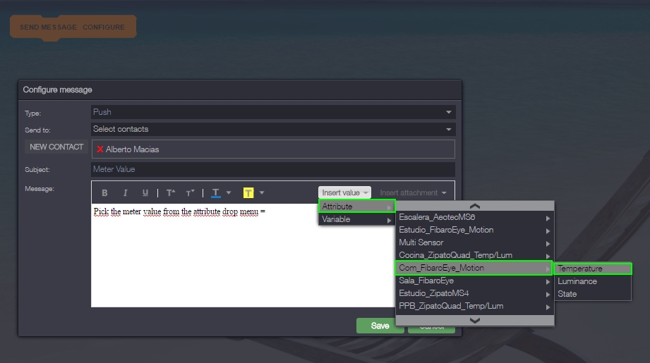

If you don't mind me asking, why are you storing the meter value on a variable? are you using it on other rule? otherwise it doesn't make sense to do that, you can use the same meter attribute on your message. That will get rid of all the extra decimal numbers.
I want the current value included in the push message to me.
You don't need to store the value in a variable to do that. Use the corresponding attribute from the desired sensor/meter, see attached.
Aaah neat Alberto. Thanks a lot :)
(facepalm). I hah not seen the scroll down bar in the Attribute box :D
No problem, It happens. Glad I could help.
