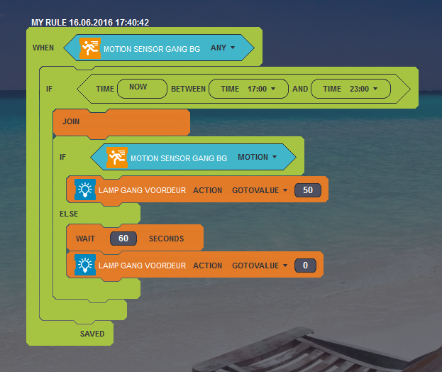

When i make the motion activated light rule from this example it won't work.
https://community.zipato.com/knowledge-base/article/motion-activated-light-using-zipato-rule-creator
I have a Fibaro Eye and a Domitech dimmeble led bulb but when i make this rule nothing happens see
example01

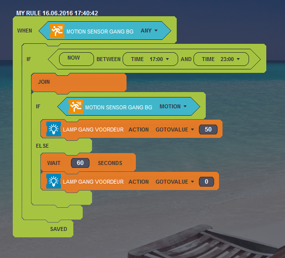

When i change the green operator line from
BETWEEN AND
to

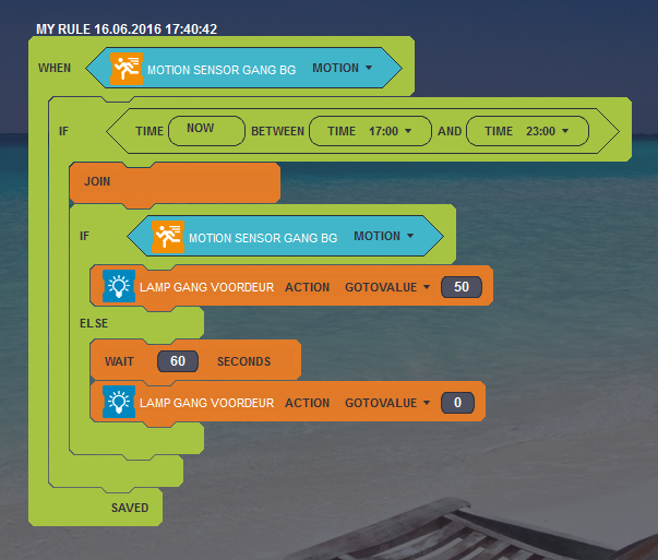

TIME BETWEEN AND
see example02
Then where there is motion the bulb stays OF and when the motion change to No Motion the bulb goes ON and stays on, never goes out.
When i change the first row motion sensor from ANY to MOTION then when there is motion the light goes ON and stays on, never goes out.
see example03
I'm new with Zipato so maybe i'm doing something wrong but i can't find what. (sorry for bad english)
Hope someone can help me with this.

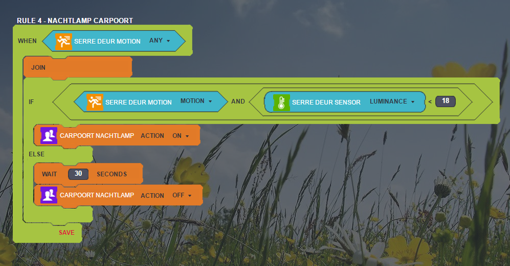

this one is mine,
instead of a time I have a luminance sensor.
so if there is motion and the lunminace is below 18 turn the light on.
if there is no motion for 30 seconds turn lights off.
Ok nice i will try this one, but it is strange that the example rule does not work.
Thanks for the nice rule with also the luminance but it does the same, the light goes ON but not OFF.
