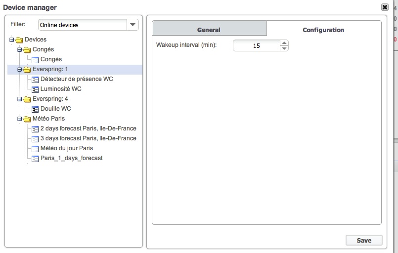

DK, thanks I found the "configuration tab" in fact I was not clicking on the folder but on the devices below. Unfortunately not all the settings are present, only the wake up interval
thomasfr, oui je suis français merci, en fait je cliquais non pas sur l'icone du dossier mais sur les devices en dessous donc je ne voyais pas l'onglet configuration. Malheureusement il n'y a que le paramètre de délai de réveil

Thanks, but in configuration I have only the "wake up" delay and the documentation mentions also sensitivity level and other parameters

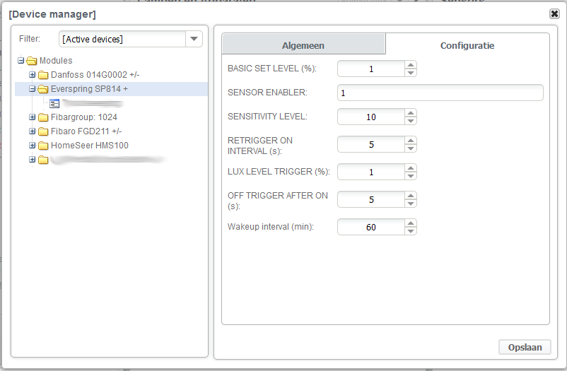

I can see and change 7 settings, but it seems like the luxlevel trigger doesn't work.
I have only one parameter (see screenshot). How did you do the indclusion?

All my devices are excluded first and then added as generic z-wave.
(Note that there is no Everspring SP814 in the dropdown-list when you add device)
I removed and then added it again, and now I see all the configuration parameters.
