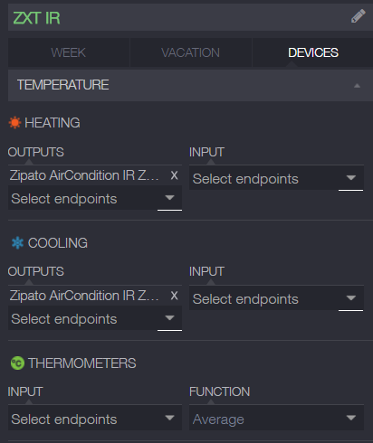

same issue here, this is happening when you create the virtual thermostat, to solve the issue i created a new thermostat and add the ZXT for heat output as well.
hope this work for you
Yes, the IR extender should be used as heat and also as cool output depending on your configuration. If you have AC unit for cooling, than it also needs to be cool output. The virtual thermostat also required a temperature unit (thermometer) which might not be the best idea to use the IR extender as it only measures if the temperature difference if more than 1 degree. This means realistically it would be 1 degree hysteresis. For cooling purpose this might be adequate but for heating might not be.
I'm having this issue with heating mode. all outputs and thermometer point to the zxt. firmware is 1.1.38. I tried beta 1.2.9, which also beeped every few seconds. Only thing that helps with the beeping is to turn the virtual thermostat off.
mine has the same problem with 1.2.9. the only way to stop it is to leave blank the thermometer input.
But then i dont know if its going to work properly if the temperature chages a lot.
it does the same thing if i use as input the ir and if i use the thermometer from the Zipatile.
I found a workaround for the beeping issue.
1. In my virtual thermostat, I use a "virtual switch" as heating and cooling target devices. This means the signals which caused the beep every 5 seconds are sent to this black hole switch now.

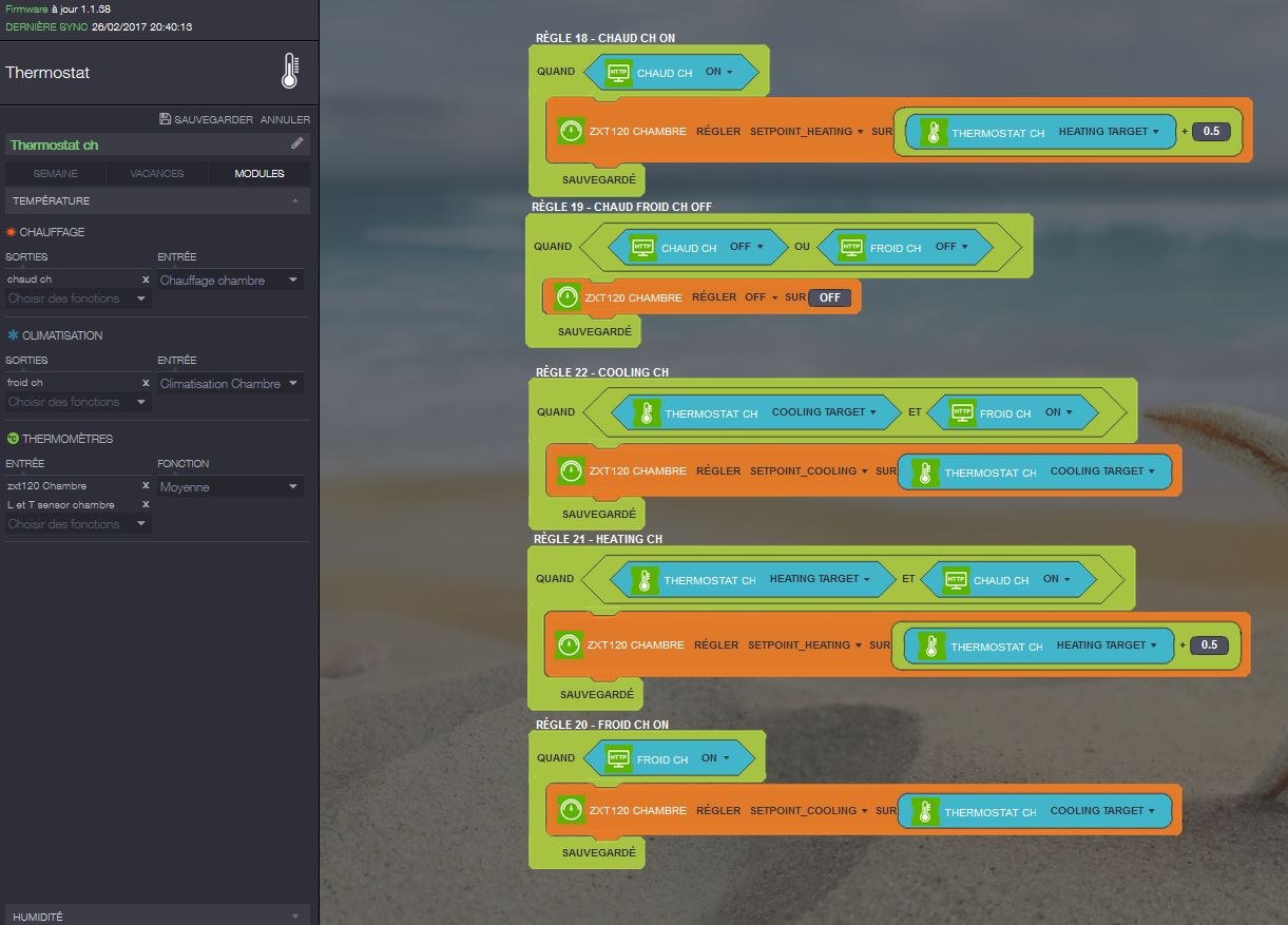

2. I created a rule which sends the real commands to the IR extender only when there are acutal changes from the thermostat. I attached a screenshot of my current rule, which only forwards heating temperature. This could be extended for cooling and other parameters I guess.

Hello, here is my programming of the zxt to have an extra regulation.
