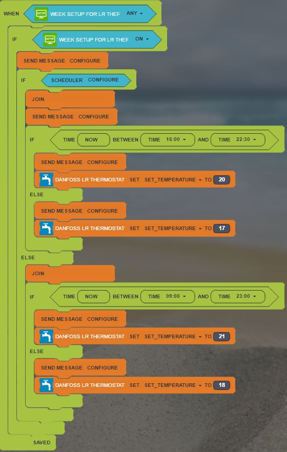

Something wrong for my Rule with Schedule my thermostat?
It doesn't continue to set the temperature - only in that moment I activate it. For example at 22:30 it doesn't go to 17° unless I switch Of the rule and then On again. So if I manually switch Off an On 2 times a day it finds the right temperature.
How to set it for automatically changing temperature?

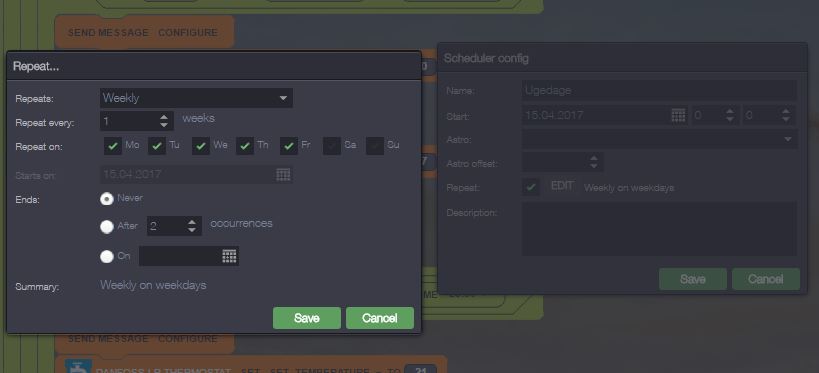

All the "Send message" is only for my self, trying to find the error. I try to set 2 different scenes - weekdays and weekends.
Best Answer
Dont put a SCHEDULER in an IF block.
I would make two rules. One for weekdays, and one for the weekend. You can even make four rules, if you want the rules to be simple. See below:

If you want only two rules, this could be an example (there are more ways to do it):
  1. WHEN ({SCHEDULER weekdays 16:00} OR {SCHEDULER weekdays 22:30})
  2. IF { TIME NOW BETWEEN 15:00 AND 17:00}
  3. danfoss SET TEMP to 20
  4. ELSE
  5. danfoss SET TEMP to 17
Please note that your Danfoss thermostat has a wake-up intervall. So it might take some time for the new temp to be submitted (up to 29 minutes if your wake-up intervall is 30 minutes).

The IF/ELSE block of your scheduler configure must be deleted and replace it with 2 IF block
Hi titof174. OK know what you mean. I will try it sometime, maybe I can use it in another situation. But for now it works with the example Jan had come with. But thanks...

Thanks - now I know that Scheduler and IF block is no go. It works for me now, with the last example you suggested.
