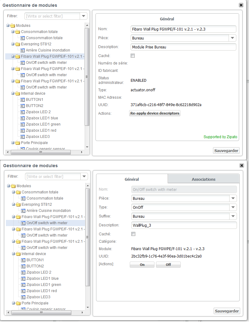

My problem is quite simple: the name of my WallPlug modules have changed name nothing I do.
I put names like "On / Off Bureau", "On / Off Salon" ... and there, without any action on my part, all my modules are called "On / Off switch with meter" .... which is quite difficult to differentiate!
Why ?
Do you any explaination / solution ?
Finally, it is impossible to rename module because the field are disabled.
Kind regards.

The problem you see...
Maybe you clicked on "re-apply device descriptors" ?That is when I end up with exact that issue you describe. (with my Fibaro Wall Plug)

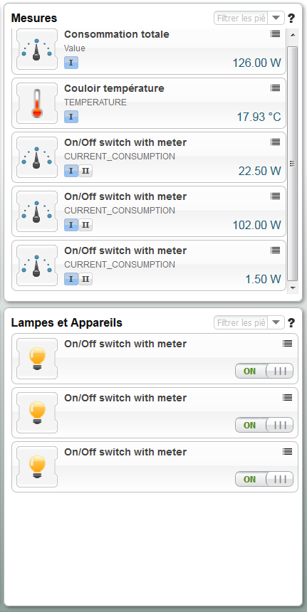

Today, it si very difficult to create rules, because all my Wall Plug module have the same name and i don't know which one to use...
The problem appeared only yesterday, before everything was OK.
I wrote to fast...
When I click on the button "re-apply device descriptors", a new button named "Generate name" appeared and it works.
All is allright !
But, I don't know the origin of the problem...
I wrote to fast...
All is allright !

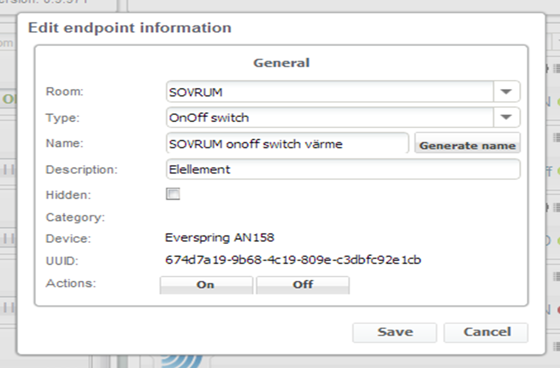

This new dialog looks much better!!! :-)
But have you decided to skip the suffix?
I can't see it in the dialog...
If I with this can enter a custom name, or generate a name based on room+type (+suffix?)
Then I very muck like it!
Thank you, and keep up the good work!
