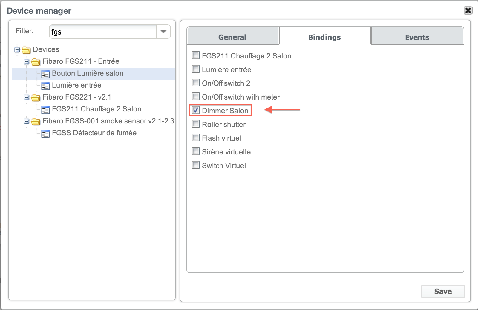

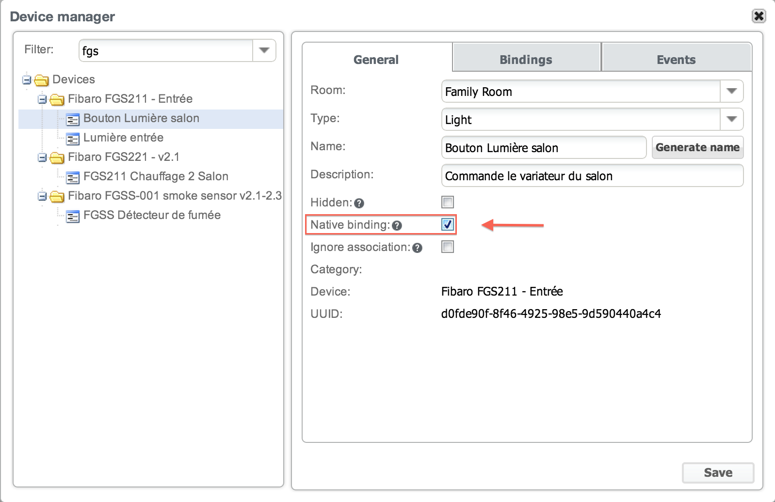

            I've created an association between a Z-Wave switch and a Z-Wave dimmer. The light turns on, but won't dim... So I wanted to make a NATIVE BINDING to see if the light would dim. But it doesn't change anything. I turned off the Zipabox to see if the native binding was effective but no : the switch doesn't command the dimmer if the box is off, even if I selected "native binding". I've tried to associate a Keyfob to the dimmer -> same problem. Any help ?
I had the same issue with DUWI wall switches.
I removed the wall switches from Zipabox since you can control the dimmer within Control Center/Rules etc
I directly associated the wall switch button with the dimmer and that works perfectly
This way Zipabox works and you wall switch works unless you demand to use rules with that wall switch.
