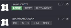

I got 2 devices ( levelcontrol and thermostatmode.)
All seems ok.
i can make a simpel rule that makes the Nest change from "away" to "home" and via versa and that works fine but i can't set the temperature anywhere... I think i need to set a setpoint but i don't no where.

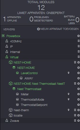

This is what i have of virtual devices.
I don't now what you mean. :(

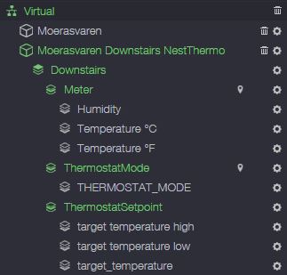

With the URL for the setpoint i get a error ( attachment)
The target_temperature is a virtual device what was been automatic beeing places in the virtual devices when you add the NEST. so i don't untherstand why i get a error when i try the URL.

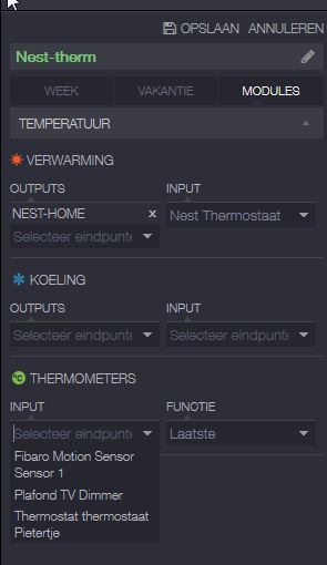

1) input: is for the physical devices that can control the Virtual Thermostat. It should be the NEST because each time you control the NEST physically, the setpoint temperature will be synced with the Virtual Thermo
2) output: is for the devices you want to control through the Virtual Thermostat. Each change in the Virtual Thermostat will be updated in the physical devices. Here also should be the NEST
3) Temperature: is the sensor you use to read out the current temperature. of the room. Either you use the NEST itself or any other sensor in the same room, or both

You need to add the nest inside the virtual device as input, output and also temperature. It seems that you have not added Nest as heating input therefore the change is not communicated back to nest.

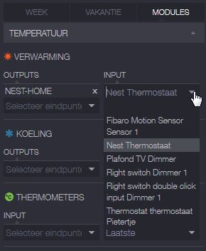

i think i understand but i don't have the options when i make a virtual device. see attachments. even the thermometers are not a option. i feel like a beginner in this... :(

I think in the input picture you have the right one selected, but the outpud does not seem right, it should be the same device. As to the thermometer, i dont understand why you dont have nest. What is thermometer Pietertje?
That is a thermostat an a radiator but that is off line. It is a project for next week :)

I can't Use the same output because It is not on the Dropbox
This is strange because I can see the Thermometer in the device list
Just expand this one (and all sub elements) and send me a screenshot.
