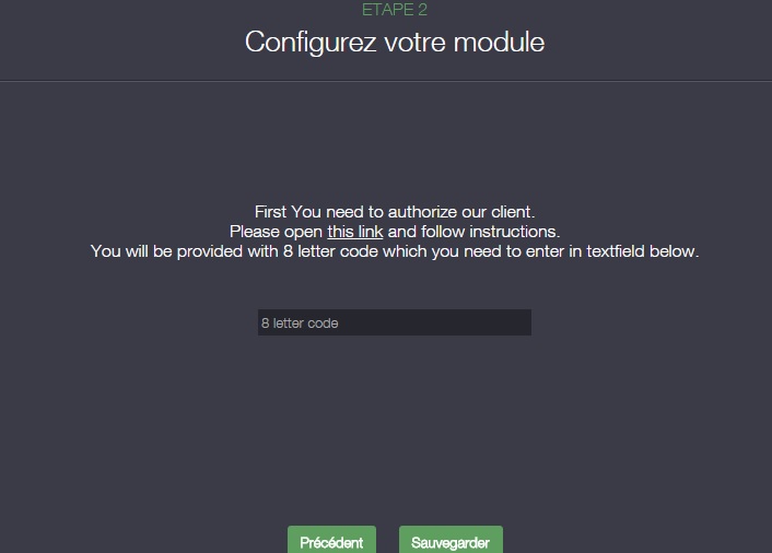

i use "add new device" in zipabox, i select NEST ( see picture 1 )
i go to the link,I write the code but

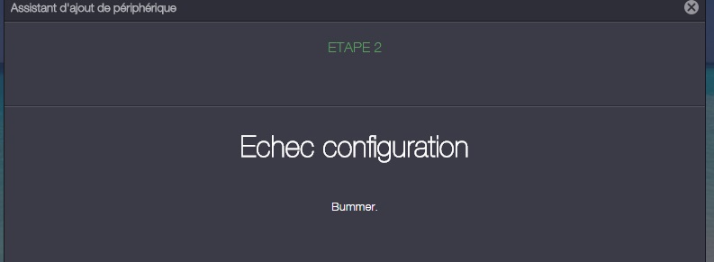

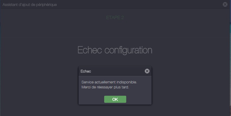

I obtien picture 2 and 3...
have you got a solution ?

Support told me their are problems adding Nest.
when adding nest the box wil geep searching for it
after 1 min stop the search and the nest is already added
same problem here while adding it returns an configuration failure > Bummer
same problem here as well :(
Not currently working. They have to do a bit of a rewrite to get it up and running, I was told.
