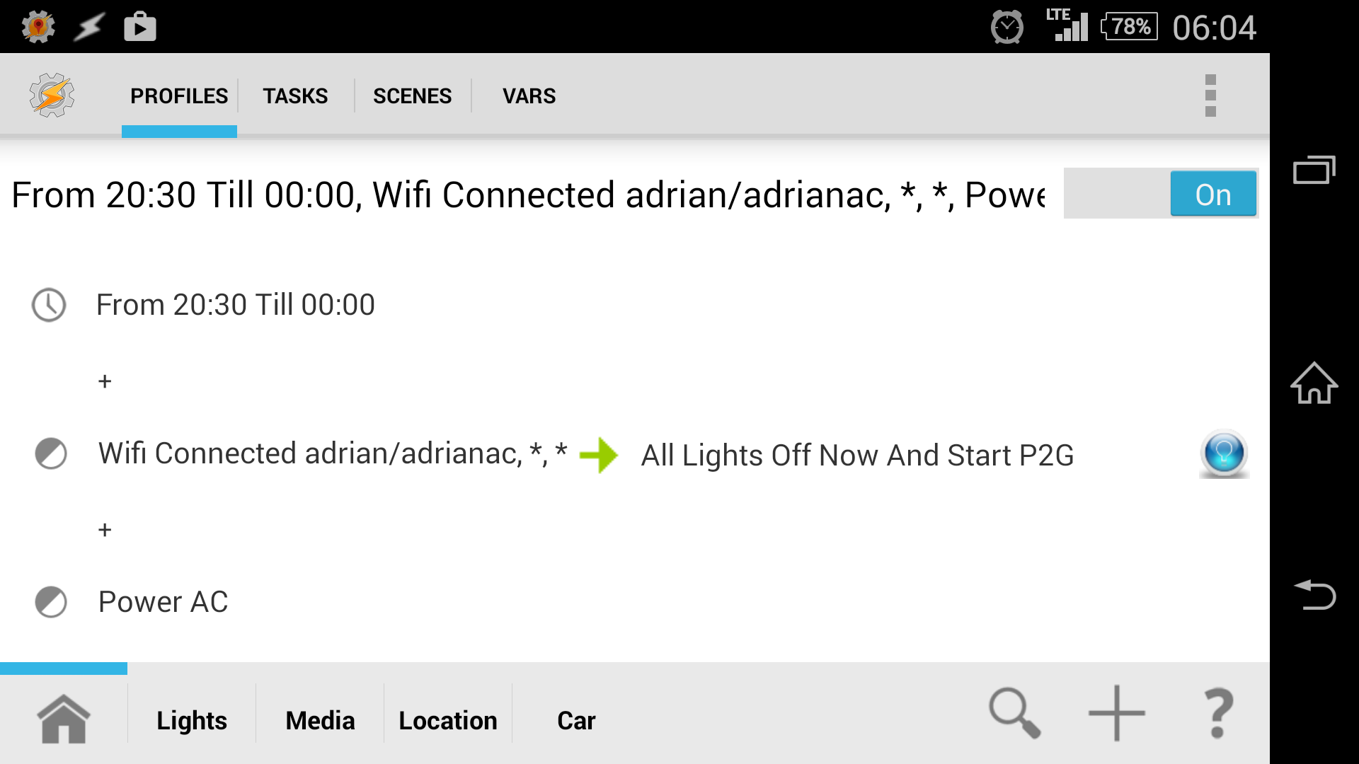

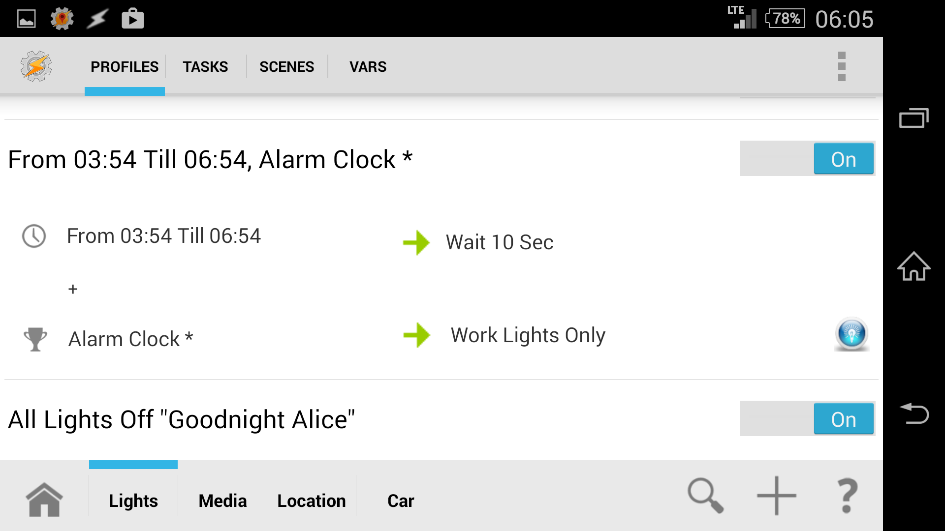

Adrian Van Der Heijden shared this idea 11 years ago
Using the Imperihome app plugin with tasker let's you create many individual and automated scenes and tasks. Some examples I have used are attached below. What can u do?
