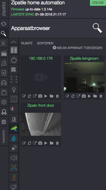

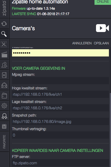

hello all,
I installed a new camera (Trendnet TV-IP314pi) that works with Onvif.
No problems to watch the streams, but I cannot make a simple snapshot.
I searched this topic, but gives me no solution,
I think that my url is wrong (and I tried a lot of different url's).
Can somebody help me with this, because I need that snapshot,
because when somebody rings my doorbell, it's making no snapshot now.
I insert some screenshots with it (cam 192.168.0.176), the problem is the snapshot URL (I think)
try http://192.168.0.176/Streaming/channels/1/picture for the snapshot.
