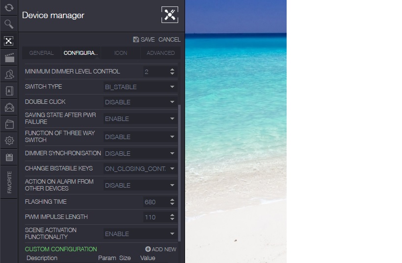

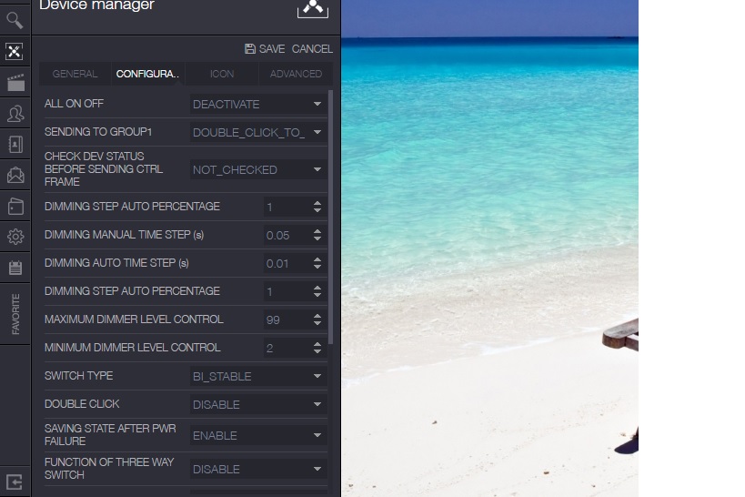

Thanks Attila & Pero for your replies.
But i dont see any of these options in the Zipatile. On the configuration tab, i cant even set it as a momentary switch. Are you guys talking about the options on Fibaro's home centre?Apologies, this is my first time with Zipatile. I have attached few screenshots.

Check sending to group 1 (parameter 6) to 2 and double click to enabled. What Pero was referring to is that you will need to use monostable switch (bell button) not bi-stable switch rocket switch.
Also parameter switch type needs to be changed.
