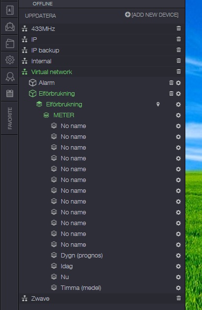

When I add a new virtual meter it by auto creates 16 subdevices. I use only 4. This becomes a problem in the new Android app, cause I have to click a lot of times to come to the correct subdevice, all 16 are in there.
I also want to delete a subdevice, this can't be done, why? If I change some parameters for a subdevice, this becomes visible in control center as a "device that I use", can I undo this if I don't wan't that subdevice visible any more?

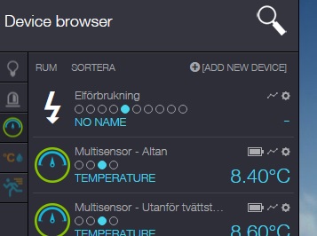

I actually did that, now I have all the devices I put to "hide in device broswer" showing instead :(
I tried this just now and got the same result, But if you reload the page or reboot, they do disappear again from the Device Browser, and also from the Event log.
General lesson: after you change anything in the Zipabox, reboot.
