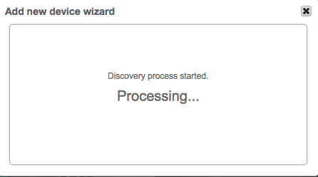

Step by step instructions:
Click Add device in "My Zipato".
Select EYCR-201 as device (try another one if this doesn't work)
Click "Join" In "My Zipato".
Push the learn button on the CMR-101 with something pointy.
Click "Continue"
And you're done!
