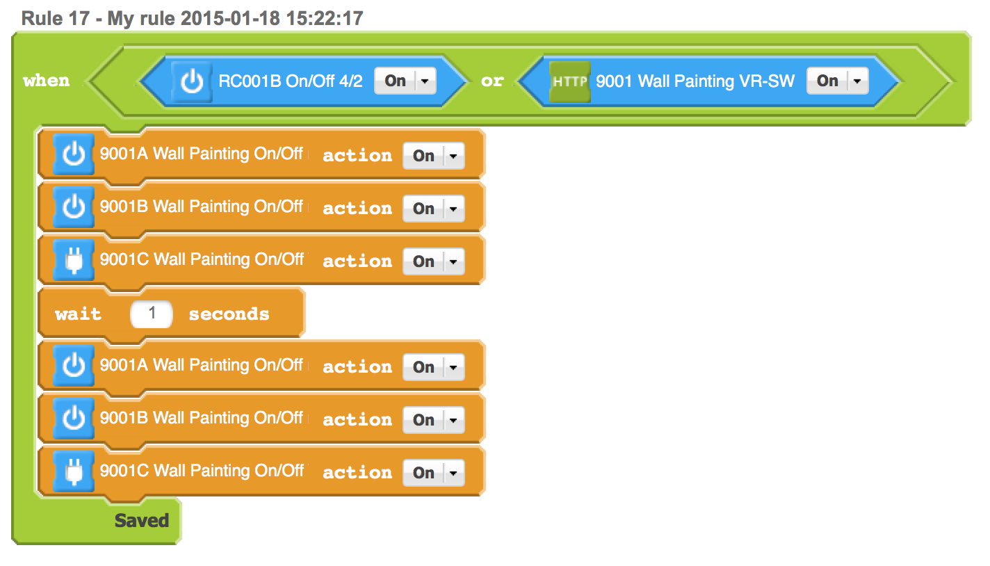

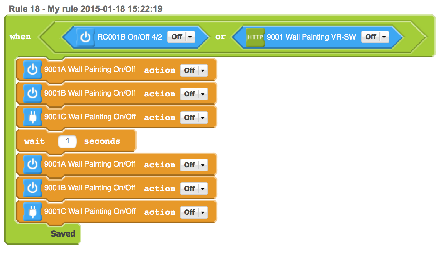

After that I tried one other thing.
I created three different type of sensors and connected them manual, I set the unit in learning mode and trigged them manually, by pushing the on button on the screen several times. In this way I created three switches to the NEXA unit. After tha, created one virtual sensor for trigging them.
With this thing I could create two rules (see the pictures), and with the two rules I can control the WMR-1000.
The solution from Zipato Team must be that you create a new type of sensor that sends the signal longer.
BR, Johan

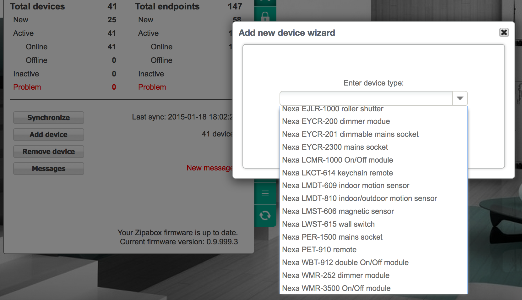

Hi Ivan,
I have now upgraded to the new official Firmware 0.9.999.3.
But the Nexa device WMR-1000 is NOT yet supported, you can´t find it in trhe list. (Please se the attache picture.)
You ca also see in the pictur that I have the latest firmware.
In other words, it´s not working...
BR, Johan

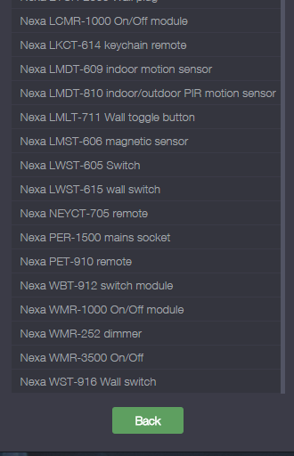

Hi again,
I can comfirm that the Nexa WMR-1000 works perfactly with the new UI.
