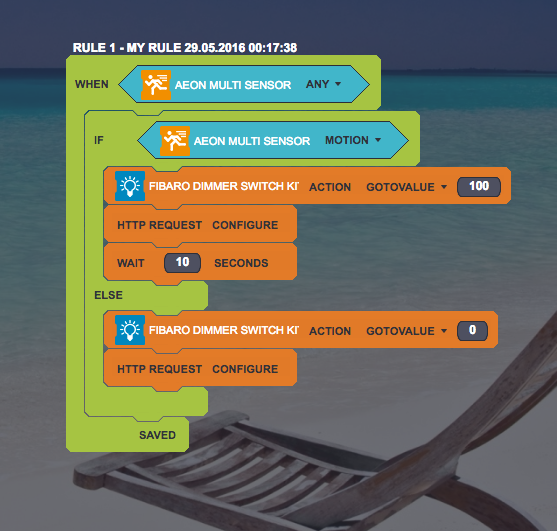

Hi, se attachment for the rule i have created. the rule dont run.
I have a Aeon Multisensor 6 trying to get it to turn on my lights with my fibaro dimmer 2(fgd212).
I have saved and synced.
The motion sensor is triggering event loging in zipato web app so its working but the rule is not executed?
Replies (4)
Looks good, why do you have a wait rule at the end?
You did sync on the right hand menu didn't you?
The wait rule was there to wait and then turn the lights of again but i se that this dont work to have that there i moved it down to top in the else statement.
sync and saved on the right side.

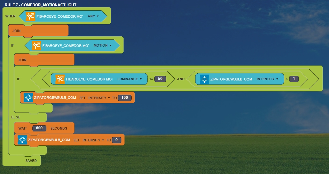

This is my setup for motion activated light, I use fibaro motion sensor and zipato RGBW bulb. One thing I noticed in your rule, you are using "Action" instead of "Set", try to change and see if it works.

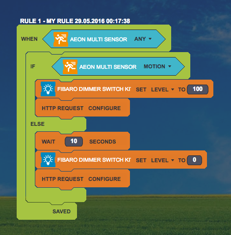

Did as you did Alberto Macias se attachment, it worked immediately when i changed it to set and level, thanks
Put a Join between WHEN and IF. This will ensure that the rule will not be executed if the motion sensor changes it state to no motion and motion within a short period (I.E. it will always run at the last trigger and the previous triggers will be ignored).
