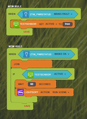

Arman,
Try something like this... The first rule will set "TestSensor" (can be called PwrFault or whatever you want) to active. Whenever the power comes back and your Zipatile is back running, the second rule will execute, wait 60 seconds and then trigger a scene that you can configure to turn off all lights, or you can turn off the lights one by one also.
Regards.
