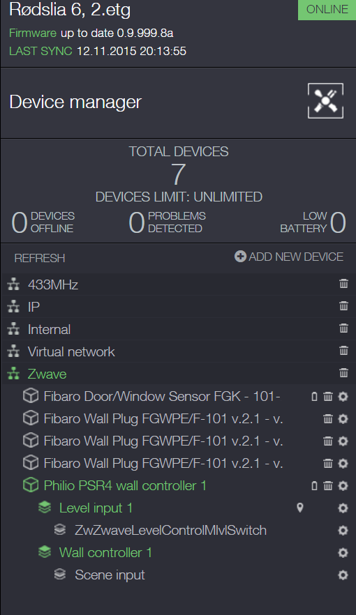

I can add the Philio PSR04 anytime i try (fails if it is out of range etc.), but once added, any action taken does not show up under events in the old GUI.
In the new GUI, the even-screen doesnt even load.
I did some digging, and as far as i can see the problamatic part is the ZwZwaveLevelControlMlvlSwitch part. This seems misconfigured?
Due to very limited raw-data, it is hard to do any digging without support from Zipato :/
Is there anyway i can update the firmware of the device through zipato?
Has anyone gotten this switch to work through Zipato? (it says -> Supported By Zipato after adding it..)
