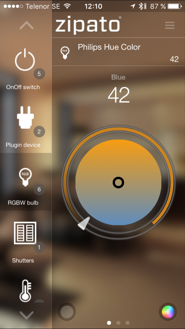

6) iOS app crashes as soon as you try to change something.

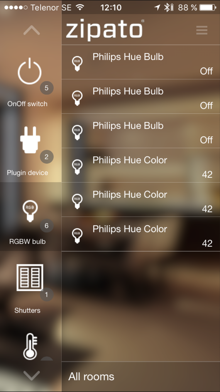

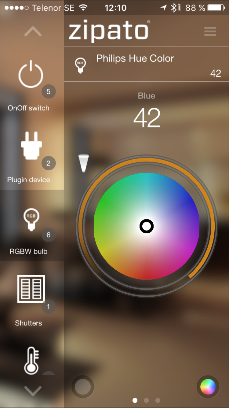

I will post a picture how it looks in the iOS app. And the app crashes if you touch any thing!
I also want to say that the bulbs do not sync with reality:
On the pictures it looks my lights is on but they are all off:

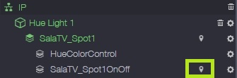

I also discovered an error. That when I add 2 different bulbs from Hue there is only one light that reacts.
2e26820e0725ca8788ea5867236a56a8

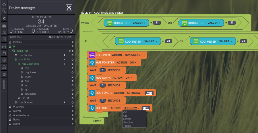

After mush work I was able to control al lights separately in rule creator. But it is hard rename the bulbs because you have no idea what bulb you are renaming.
You have to test every single bulb in a rule to know what bulb you are working with.
I should also say that the bulbs not always react, althow I have used 1 second delay between the lights. I have med a rule for Kodi that should turn on and off 2 bulbs in the living room when play, pause.
723f99b042566a277d96ac5de34c4122
Very inconvenient when you have named al the lights once in the Hue app. And al other apps can see the name of the lights, but Zipabox can't!

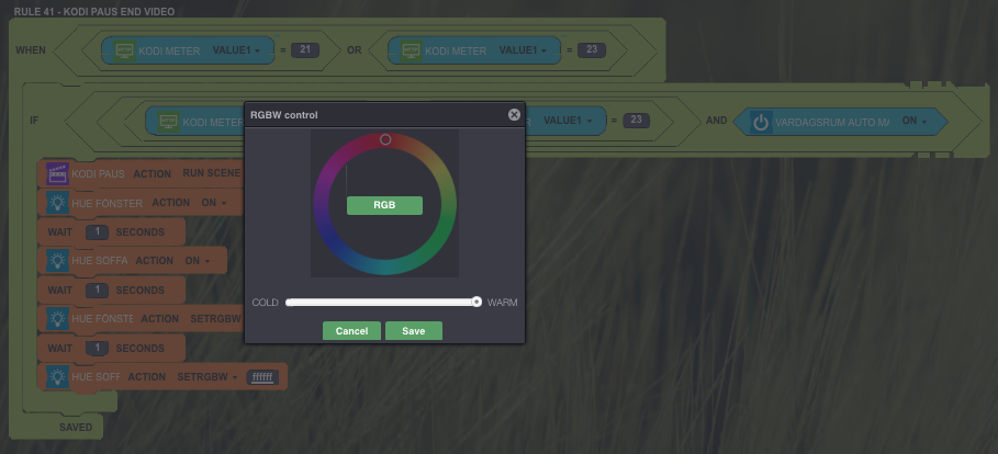

After more tests the warm color is not possible to set in rule creator. When I drag the slider to the warm scale the color ffffff is set on the block. And instead of warm color I get cold color.
http://www.color-hex.com/color/ffffff
And also I can not send a light intensity to the light bulb.

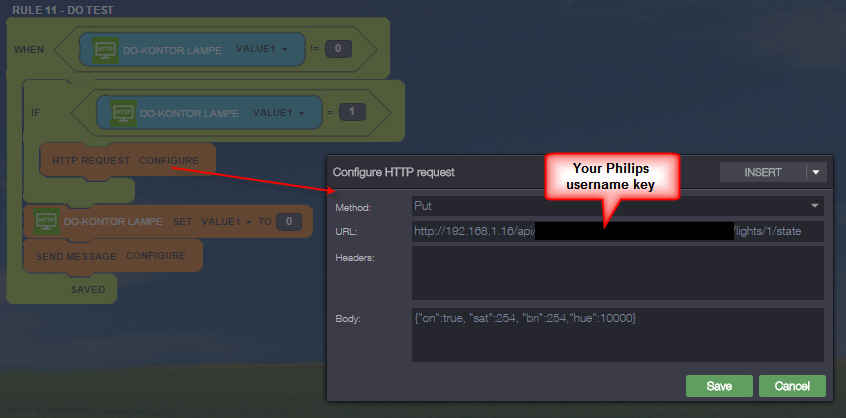

Anyway I remove my Philips Hue from Zipabox and got more stability. I now control my Hue light with HTTP Request instead, it is much more flexible and you only need one line.
To set it up first time can be a bit tricky, if you follow this instruction step by step it is actually working very nice http://www.developers.meethue.com/documentation/getting-started
After going threw the "getting started guid" I could control my lights with my web browser. But what is the rule you posted for. I don't get any value in to the http device.

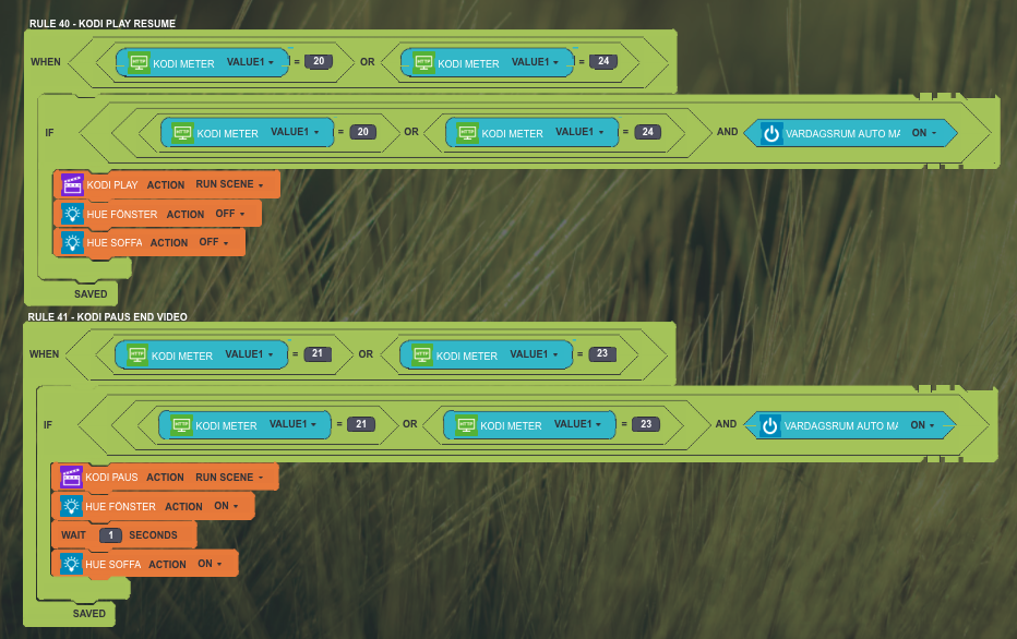

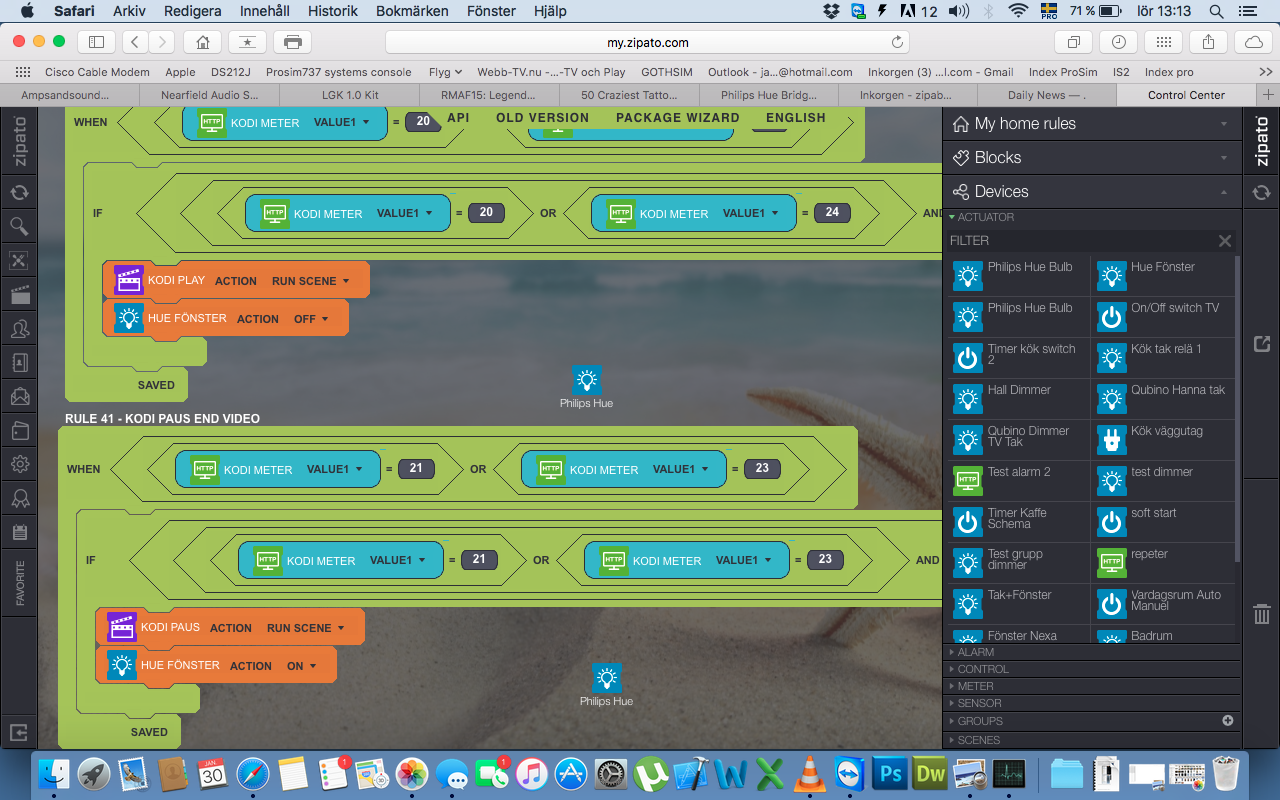

One rule that I want to use is a rule that the philips light intensity follow my ceiling light in my TV room or have another light switch for it.
But still it would be nice to be abel to control the philips lights like the Zipato bulb in the iOs app!
My rule was just a test of the DO button on the iPhone, it turn on HUE light1, the send message is only to see if the rule is running.
You can use the HTTP Request as any light or switch, the critical thing is how you Configure the HTTS Request.
In Philips Hue you can also Group he light and use the group in the HTTP request.
What I learn was that copy and paste not always work even if it looks correct.
So technically I can just use HTTP Request to send Hue lights on and off.

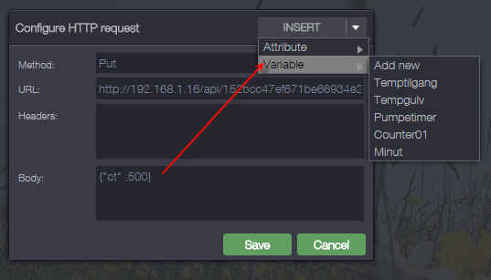

Is it possible to use a virtual level to send different ct value and another virtual level to send different light intensities?
In that case could you show me?
Best regards Jacob!
Yes you can use HTTP Request as on-off

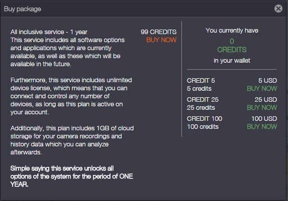

In theory you should be able to use variable in the HTTP Request, but is will ask you to buy package, I have not try this myself, is there anyone that know if this works ?
Hmmm..... what could I say not worth it.

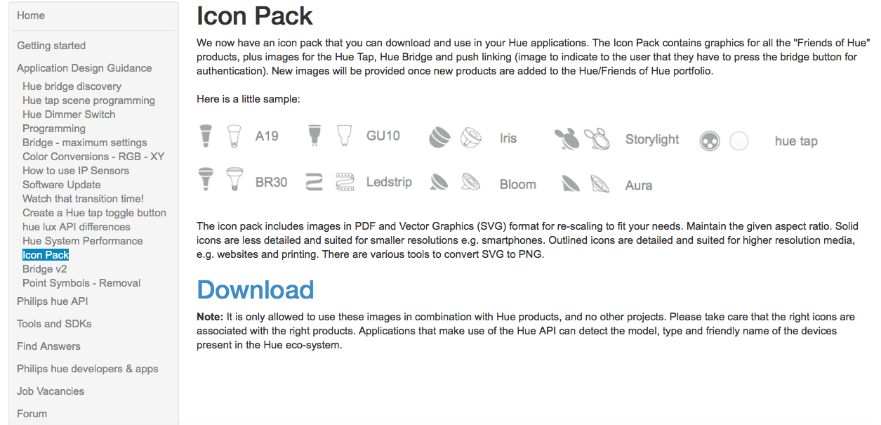

Ther is even a Icon pack Zipato could use when integrating i there system with Philips:

If you enable the visibility for the ON/OFF endpoint you can see if your bulb is ON/OFF. I know, is not ideal but at least you can see the real status (with a small delay) of the bulb and also toggle it (useful if you want to keep using the same setting most of the time)
LOL, now that I remember you showed me that... thanks again
