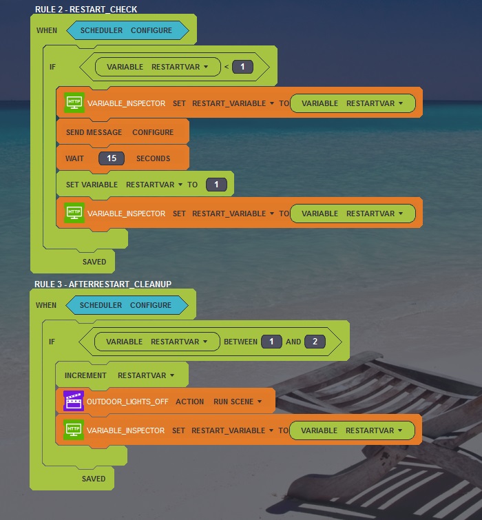

Hi, I have a scheduler that sets the value of a variable to 1, if it is 0. And then another that checks if the variable is between 1 and 2. If it is, the variable is incremented, and my outdoor lights are turned off. So after a few runs, the Variable goes to the value 3, and then never enters the rules again. But at a restart, all variables are automatically set to 0, and hence it is detected again. See attachment. (The Variable_Inspector is a virtual meter, to be able to follow/trace how it is working, as there are no debugging options).

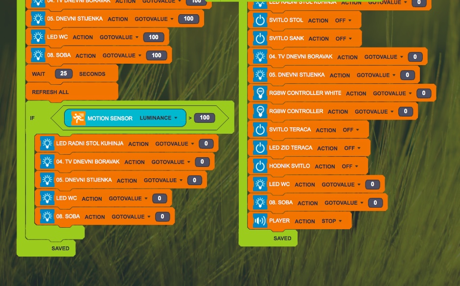

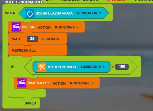

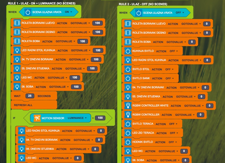

You can see from attached my simple "HOME" and " AWAY" rules.
"SCENA ULAZNA VRATA" are simple bistable switch connected to Zipato MM double switch S1 which I physically press when enter home to raise blinds and switch light on if there is no sun light from outside (HOME) and switch everything off when leaving home (AWAY).
BUT if Zipabox restart spontaneously it will execute that same rule when I don't want (exactly 20 min after restart).
This is not normal, and finally after more than 3 years I have answer from Zipato:
After reset Zipabox asking all devices for status and mostly all devices answer with only Online/not Online status, but Zipato MM double switch answer also with state and that is what trigger my rule when I don't want. (original technical support answer on Croatian below)
You can imagine what kind of problems that can produce, for example, physical switch is ON (HOME) after arriving home, than I go to bed and switch OFF all lights with my phone and OFF scene. Than in the middle of the night Zipabox reset and again trigger rule "HOME" (switch is physical still ON as I am still at home) and than all light switch on and blinds start to raise and everybody is awake and crazy without knowing what is going on.
