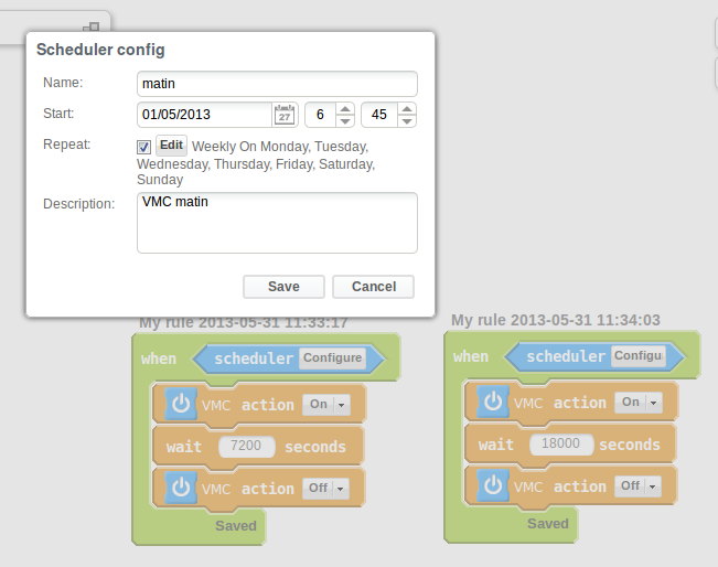

I want to start a VMC (aerator) every weekday at 6:45 am and stop at 8:45 am, and restart 5:00 pm, to stop at 10:00 pm.
What is the best way to make this rule?
For me the scheduler is not enough comprehensive.
Like this :
Thanks.
Noproblem. I'm glad to help.
I don't know another way for your VMC. I use 2 rules to turn things on/off.
Got a idea...how to not use the delay
Make 2 rules
1 for turning on...like this:
glsR8mv7r2A4u8o5TuVv
And 1 for turning off
