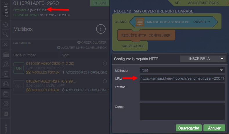

Problem update firmware
Since I upgraded the firmware (1.2.20) I can not receive sms.
Https://smsapi.free-xxxxxx.fr/sendmsg?user=20071587&pass=IZPLnrPFn7Kzqw&msg=overture porte garage
How to solve the problem?
cordially
Eric
            sms ouverture p...

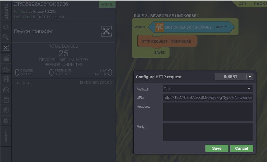

Same problem here!
there is not any of my HTTP get rules works
Here are a eksemple
Same problem here!
Here are a eksemple

John, please try again after changing the method from GET to POST.
That worked for me.
Roland
That worked for me.
Roland
@Roland K,
Unfortunately it is not possible
The API which I communicate with expecting an HTTP GET
John
@Roland K,
John
