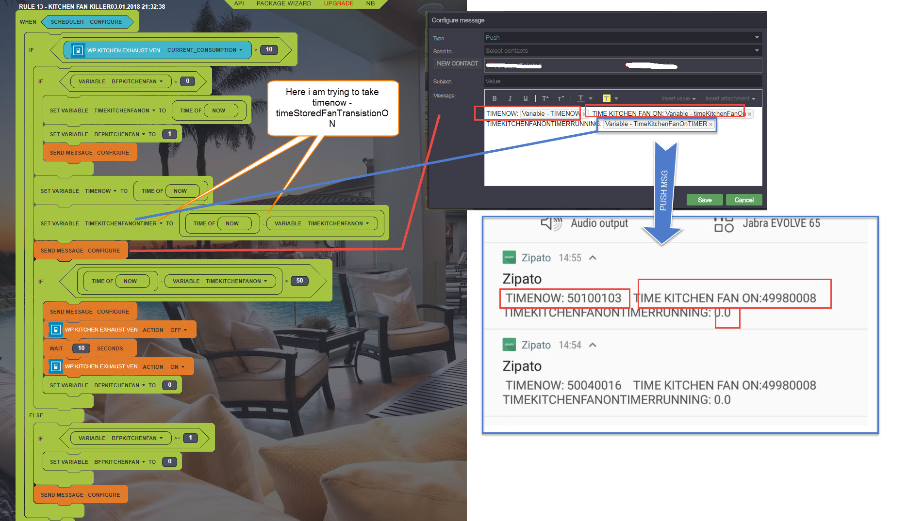

I have made a function for detecting a kitchen extract fan being on for too long, and give a push notification (and switch off power suplly in next step) if we forget it. I have made the function work part from one thing: i cannot seem to be able to subtract time values?
i use the function timeof (now) and add that to a var1 . I then add timeof(now) at a later stage to var2. I then want to use the result of var2-var1 but it is always 0. I see in the push notification that var 1 is e.g. 80000178 anv var2 is 79005367. I assume this is in milliseconds. But when i try to subtract one from the other i always get 0.0....

yeah, i tried to assign time(now) to a variable, then time(now) later on to another variable, checked I had values i both variables and tried to subtract them, but still no joy..

The date-time values in the Zipabox are Unix values and apparently too long to be stored in variables. This is why it never works.
I have found that the largest value variables will accept is a Unix date-time value converted to measure hours rather than seconds (see post).

Thanks mate! This definitely explains the reason for the behavior. I tried to pull out only the minute section to test in my code and can confirm it works then.. I agree that this is functionality that should be supported by Zipato, since the variables can hold float values they should be able to calculate with them as well....
