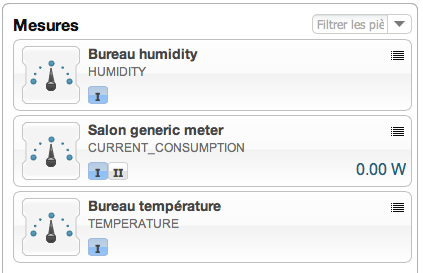

I have added the device but the temperature and humididy are not visible on my dashboard. Could you tell me why ?

Update to new version of firmware (0.9.9.6) and synchronize.
Now if you still don't see temperature and humidity endpoint in meters widget,
it's probably hidden, so go to 'Everspring ST814' in devices and uncheck hidden in 'Temperature and humidity' endpoint of that device and save it.

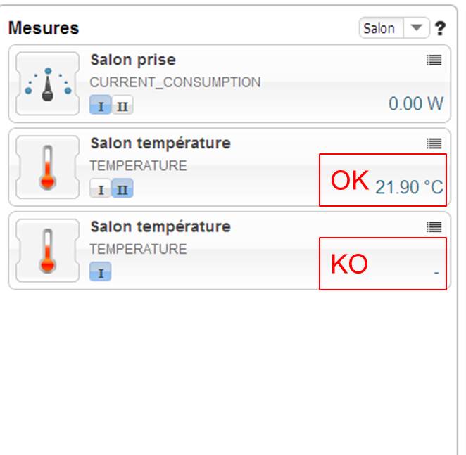

I got a slightly different problem:
* The endpoint with the 2 measures (both humidity and temperture) works fine
* I also want to have the endpoint with only the temperature and I do not have any value (cf screen shot)
firmware:0.9.94
