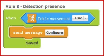

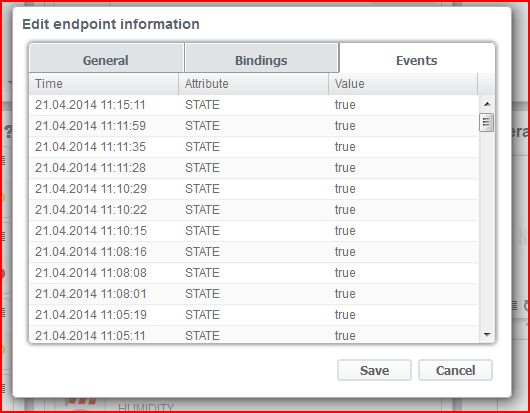

HI, i joined a Philio PSP01 to my box. There are events in the motion sensor, bur when i make rule with the motion sensor, it 's does'nt work, no action action

It should show no-motion, motion. Please rejoin.

hi, it's ok now for the motion sensor, the rule work. thanks

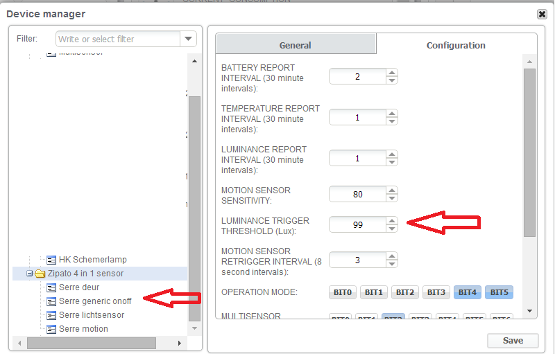

only now its not called PSP01 4 in 1 sensor but, zipato 4 in 1 sensor.
also an extra feature luminance trigger. no idea what that is doing.
some explanation about that please.
Luminance trigger functionality is described in the manual of the device, under the
"Z-wave configuration settings" section, configuration option number 4; "Light threshold".
