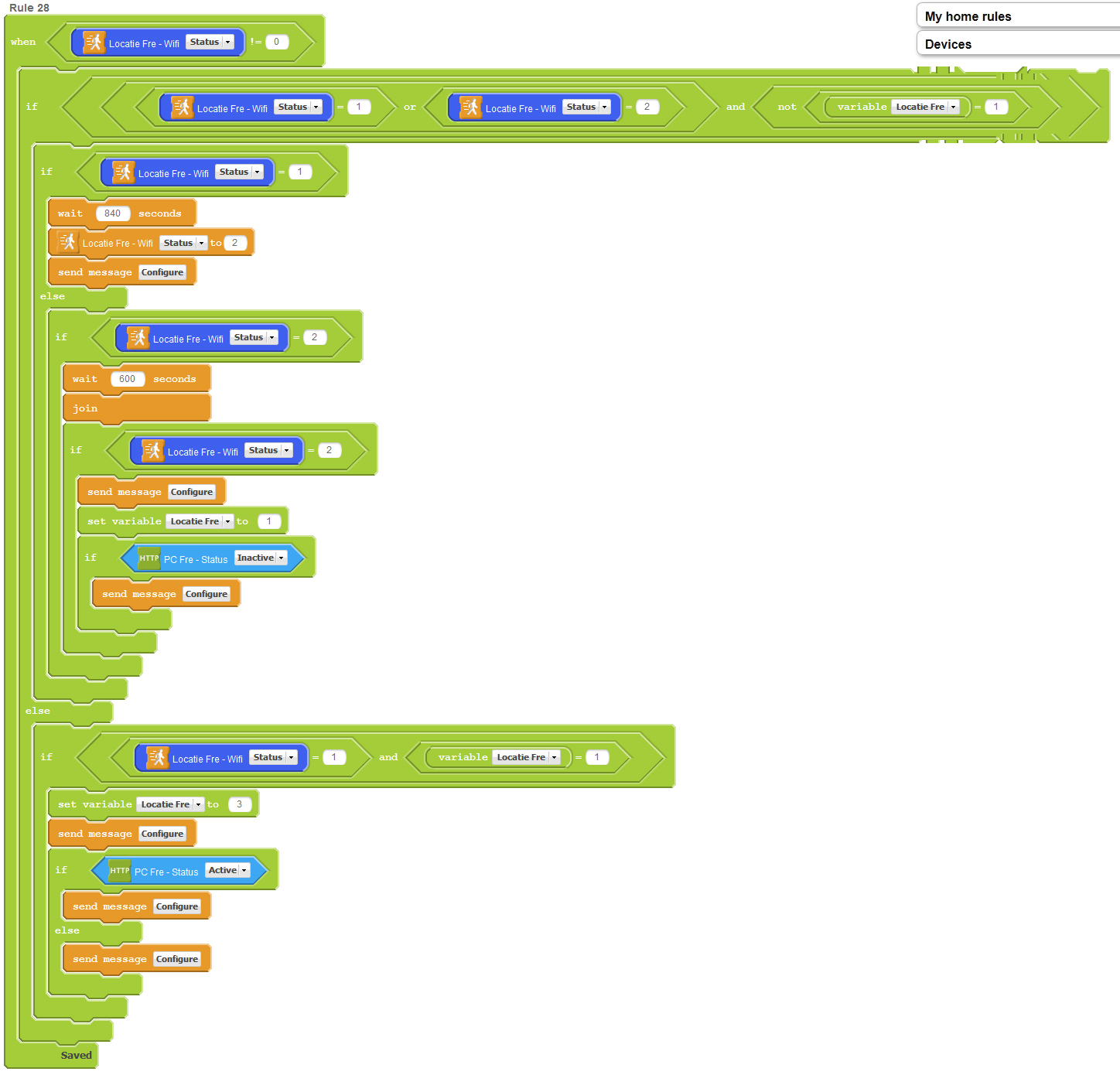

Hi All,
My wife has no data connection on here phone but i want to know if she is home. To check if she is home i have an trigger on here phone that does the following:
> Check every 15 min
> Wifi Home is Connect
> Then send http request to zipabox (Locatie Fre = 1)
(i'm using www.automateitapp.com)
On the zipabox i recieve the request as a meter and does the following:
When Locatie Fre = 1
Delay 14 min.
then Set Locatie Fre to 2
So i reset the meter ever 14 min. and after 1 min the phone sets it back to 1.
I check after 6 min. if Locatie Fre = 2 (then she is away) and if not then she is home (trigger from the phone runs)
But i can't get it to work. Some how the systeem doesn't see the 2 coming in. I see it the logs. (1, 2, 1, etc). But some times the 2 misses and runs the whole script.
I use the attached url.
Can some help me with this idea/rule?
Replies (1)
I got it!
It was not getting/checking the Locatie Fre = 2. So i put the Refresh All in it. And now it works fine.
