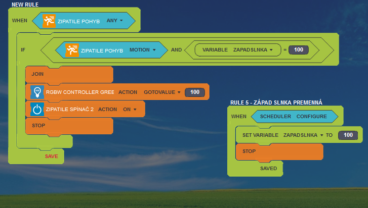

My goal is to open blinds when somebody get back home. I have a motion detector for this. If motion is detected, alarm is disarmed and current time is between sunrise and sunset then it will open the blinds

Hi, I also use variables to set the night/day accordingly. So have a main rule that runs based on astro offset and sets a variable "Sunset"to 100 when it is night and to 50 when it is day. from there any rules that require sunset or sunrise condition, the variable is used. If you are refferring to this approach that u use, than it is fine. Other approach is to use virtual switches instead of variables. Their state should nowadays be preserved regardless of the box reboot. perhaps try that and give me your thoughts.
As to the motion activated disarm and opening blinds in daytime. here is a sample rule. The bigger rule is the one that does the actions. In there the variable is set to ensure rule only runs in the night. You can reverse this in the small rule. The small rule runs every day and depending on the added virtual location it is set at sunset (or for your case sunrise) to 100.
Hope this makes sense.

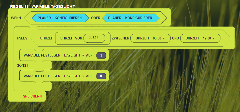

Try this.
The scheduler runs every minute or every 5 minutes.
regards Maik
Try this.
regards Maik

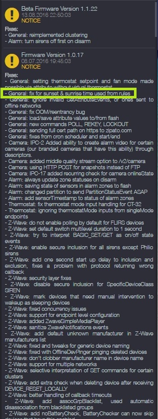

Apologies, I have been misinforming you. When you use the sunset/sunrise values (which are strings) with the "hour of" piece, it appears to cast them to a valid time value - and it does seem to work. I had tried them without "hour of".
However, it seems that something regarding sunset and sunrise in rules was fixed in firmware 1.0.17, so maybe that's the problem you were all encountering. I just tried:
time(now) between time of (sunrise) and time of (sunset)
and it's working.
and it's working.
David,
Indeed the log shows fixes on 1.0.17... no problem, I use a virtual sensor for sunset/sunrise so it wasn't really bothering me, thanks for the update.
David,
Ok that works now
