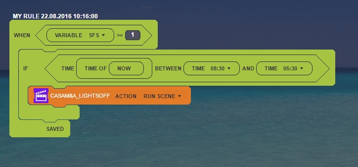

Can someone tell me what is the issue with this rule? When I try to save I get the error "WHEN clause has no event dependency". I'm trying to run a scene every hour during a certain schedule, I have a variable that its turns ON for 15 seconds, every hour already, and want to use that variable to trigger this rule.
2016_08_22-0012...
The problem is with the variable in the when puzzle. I just tried the same and same error. You should replace the variable with a virtual sensor or other virtual device.
Im not sure if this is fine, but currently the only way to do. Looks like variable cannot trigger a rule.
