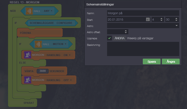

Can you help me get this rule to work?
I want it to light a lamp every weekday at 4:30 when the motion sensor activates it.
I am sending a picture of my rule so you can see how I intended it to work.
Have a good day

Hello again
And if I want the lamp should only be on when motion starting at 04:30 from Monday to Thursday?
How do I solve it with a rule?

Don't know for sure but try this:
When motionsensor=motion
If <(now)=(Time=0:45)>
Light=x

Ooh i see now what you mean :)
When MotionSensor=motion and time (now) between (04:30) And (05:30)
If NOT part day of week of (now) = 1 and NOT part day of week of (now) = 7
Light x (action) = On

You can also try this one:
WHEN MotionSensor=motion AND time (now) BETWEEN (04:30) AND (put the hour you want it to stop)
IF part day of week of now BETWEEN 2 AND 4 (I am pretty sure to have read on the forum that sunday is used as first day of the week, but correct me if I am wrong)
light x action = ON

I do not really understand how the rule should look like. Could you make a rule in the rule creator and show me?
I think you can make it this way
