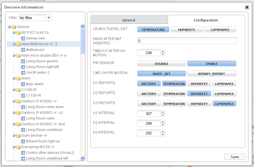

Guillaume, you can setup parameters of your aeon device if you go to the device manager within a "general widget", select "aeon multisensor" and than select "configuration tab" (please find picture attached). Here you can set "response interval" for each atribute of aeon sensor. After you change the configuration, you have to "SYNCHRONIZE" to apply changes to the device...
Regarding the temperature, there was a certain issue with the default configuration of aeon multisensor (sometimes it didn't fully apply to the device from the first wake up of the device), now we changed the default configuration and this issues should be solved.

I don't find this device manager / general widget > configuration tab sorry

Ok i found the device manager, what is this value ? Min seconds or hours ?
seconds
Thanks ! perhaps you could add this information after the field ;)
agree with you...
Added ;)

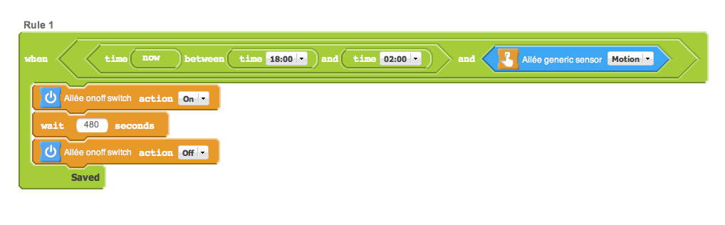

I tried to put a rules for my aeon but it totally don't work.
I also see that the motion works on the controller because the red light show when i'm front of it. But in zipato last event it doesn't show the motion_on :(
I attached the rule
