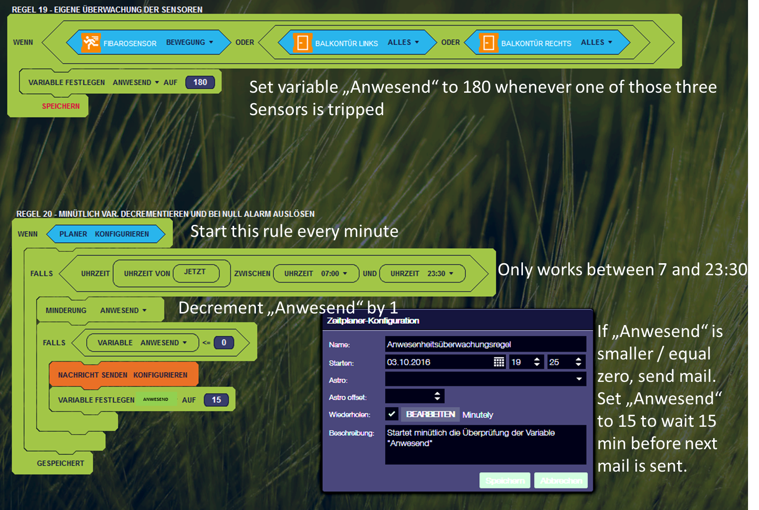

If you have the same problems, this could be usefull for you. The fact is, that Zipabox is such a meighty tool and if you e.g. only want to observe some sensors during daytime it meight be even easier to use your own routine. So far this seems to work quite fine and it has an additional advantage: If my mother falls down to the floor at let´s say 20:00 and doesn´t move at all, a three hours healthcaremode would start all over again next morning, assuming it stops at 23:00. So it will only fire an alarm three hours after the next activation. This rule would continue to count down and send a mail right in the morning.
If you can´t add all your necessary sensors in the first rule, than just put the "set [variable] to 180" (or how many minutes you need) just in any rule which is activated by your sensor for whatever purpose.
