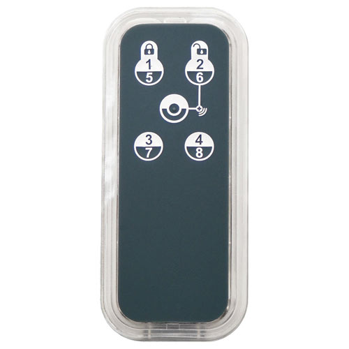

I see nothing attached besides a picture of the remote....

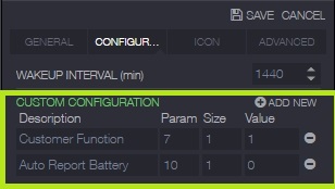

Willias,
Once you added the control to zipabox/zipatile go to device manager and click on its settings (little gear icon), then use the custom configuration area to add the following settings.

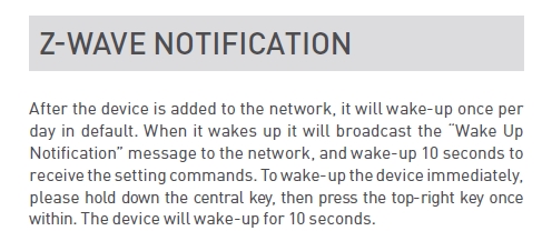

Make sure you SEND the configuration to the controller and when the interface says "Please wake up your device" you need make the wake up procedure .
Willias,
