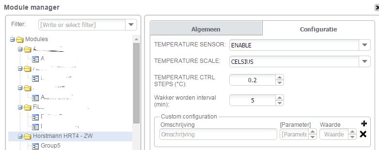

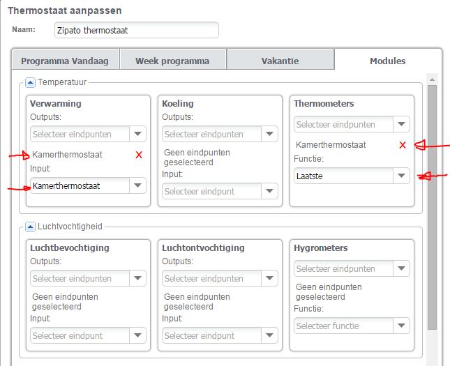

Here are the settings i used, works fine now.
When a change the virtual thermostat value, within 5 minutes the SRT321 updates and shoes the new setpoint in the display.
Be shure that you update the SRT321 to a wakeupvalue of 5 minutes
SRT321 switch 1 in up position and then in LI mode
then syncronise zipato on website

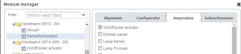

Excellent. I was missing the checkbox in associaties (sic?). After putting that in I could choose and save the theromstat as output in the virtual thermostat, and it sticks! And it sends "set_temp" to the SRT321. Before having the checkbox I could choose and save, but the boiler would turn up as output again.
Since I had already included the SRT321 in my system I did not need to do the switch 1 and LI mode. I just had to wait fo the next wakeup.
