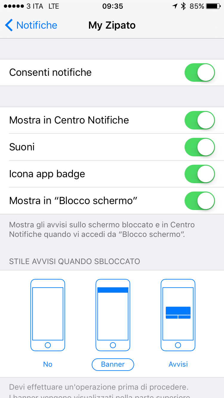

I got a strange behavior with the push notification. I'm also using the direct push-method from Zipabox and in fact I get ONLY the sound without any banner, text and badge.
Of course the notification is configured in the right way (see attach) and I altro tried to remo the app and install again; restart the iphone, and so on.
But I get ONLY the sound...
Any idea?
Any idea?

Dear Carlo,
Our team have test your scenario. You have only enter the subject inside message puzzle.
It will be necessary also to enter dedicated message inside message puzzle.
Please let us know, if the issue persist after this step.

Dear Carlo,
Pero Zovkic
How it works!
Thank you!
How it works!
Thank you!
