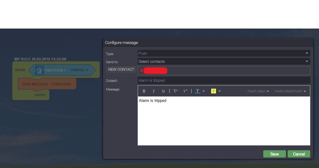

You can use our iOS Zipato application and Rule creator to achieve this task.
In Rule creator you will need to setup rule with the message puzzle that will send you push notification when alarm is tripped. Please see attachment. It will be necessary that you use same credentials for iOS application and for Message puzzle.

yes i did as you told me but nothing happened
whatdo you mean with "It will be necessary that you use same credentials for iOS application and for Message puzzle."??
Do need to setup any apps on ios into i will receive the notification messages? or where i get the push message?
Dear Hani,
We mean that you login to Zipato iOS application with the exact email adress that you use in message puzzle.
You will need to download Zipato application and be logged in.
