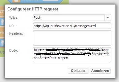

Anybody using Pushover? and knows how to make it work? (without using the email way).
Nevermind :) Got it working with xml url.

How did you Solve it? Example?

>> Go to Pushover website and make an account
>> Download Pushover on your phone
>> Start app and register your device
>> Create application on pushover website
>> Login on your zipabox
>> Create a rule with a http request
>> Method: Post
>> Url: https://api.pushover.net/1/messages.xml
>> Body: token=See Device&user=On Dashboard&title=Alarm&message=Some one is stealing your tv!
>> Save and sync
>> Rock and roll
Works very fast! And also u can change the sound on your phone for a high prio push.

I need some help with this

Look here:
http://www.domotica-blog.nl/post/push-notificatie-op-zipato
