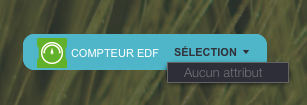

I've bought a z-wave module "Qubino Whole Home Meter Simple" and I can't use it in rules function. No attribute is possible (or visible).
The module is OK. I see all parameters in module menu : CUMULATIVE_CONSUMPTION, CURRENT_CONSUMPTION, VOLTAGE and other.

I'm afraid Jose was right. I did waste my time. The factory reset made no difference. In fact, I'm pretty sure I did a factory reset when I tried it the previous time. I used the long network cable to get the controller close to the device, too. The result was the same: all the meter attributes appear in the Device Manager, but not in the rules.
This looks 100% like a Zipabox problem. The device is reporting all its numbers properly. It's the Zipabox node configuration that is wrong. I notice that, when including the device, I'm asked to provide a name for it, but that name is then ignored. I had to change it myself. Also, no type is assigned to the device (I set it to Generic Meter Meter). After setting the type, it's possible to get it to appear in the Meters section in Device Browser. However, the attributes don't appear in the rule creator because the wrong node is showing up there - one node up from where the meter attributes are.
