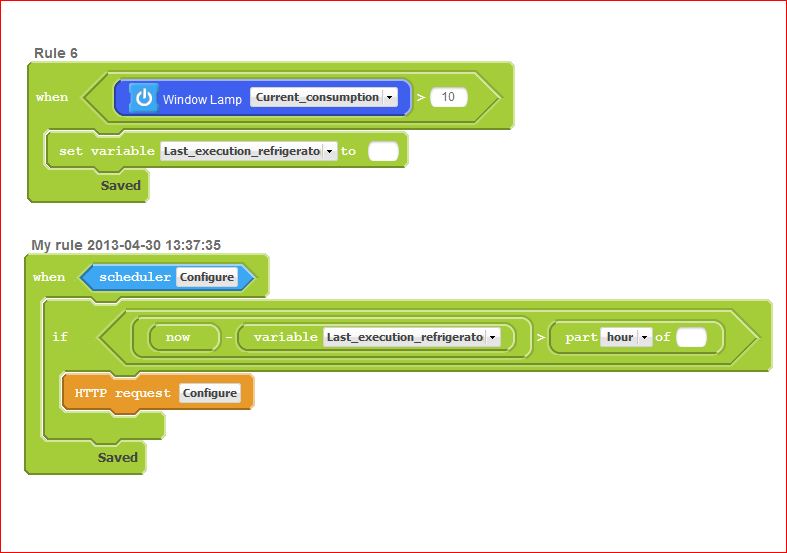

Thanks! Ill start by checking the running consumption when compressor is off/on since I guess it's never 0. (Image me open the door and light turns on)
So i tried and failed... :)
- How do i set the variable to "NOW"?
- How do i compare the times with "1h"?
Trevlig valborg!
Trevlig valborg!

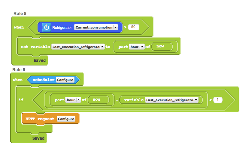

Hi Kristian,
I'm also trying this but can't get it to work. Do u have a solution yet?
Hi Kristian,
HI! Yes, i think so... :)
- Every time the consumption is over 50w i set the variable to the hour of execution. eg. 10
- I then every hour check if the "now-hour" - variable above is greater then 1.
eg. 12-10 = 2 (2 hours since last execution) = Alarm
