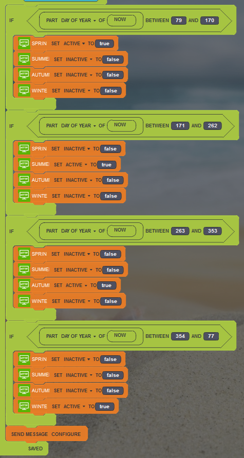

Hi, did anyone experiment with seasons? Im currently starting with my garden and plant watering solution and need to know if anyone has implemented a reliable spring, summer, autumn or winter virtual sensor or level or something? Ideally one virtual devise should be used to not overcomplicate things.
The idea is that the watering to only take place when it is spring-autumn season...
I figured out. Thanks to Vedran for advise. Attached the rule. It runs every day once and then checks which day of the year it is and changes the season sensors state accordingly. Rock solid reliable rule without variables.

Hmm, for this context not sure, surely it is not possible to accidentally mess up which season it is...then different rules would start to work...
I mean, if you created four virtual switches and set them to on/off, it would work just the same, right?
it will, but then if someone accidentally switches one of the season to a different state, it can mess up the other rules dependent on the state...
Couldn't the same thing happen with the virtual sensor?
You cannot switch it manually. Only by rules or via https link
