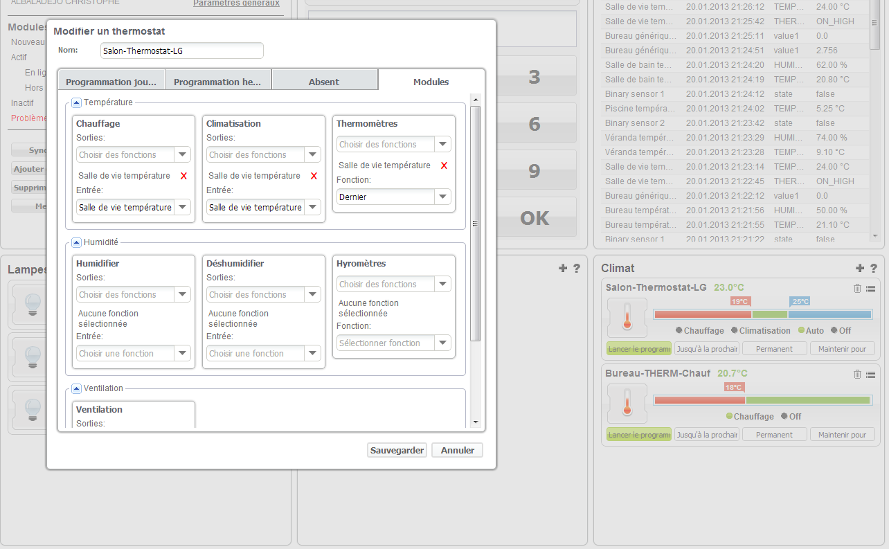

I have a ZXT120 Remotec with my Zipabox and an LG AC.
I succeed in programming my AC with rules and Climate Widget.
If you have many compatibles codes with you AC, you must try each.
In climate widget put your ZXT120 in "Output" and "Input" (and Temperature if you want).
For rules you must configure codes (easy).

i succeed to do ZXT120 work in climat widget auto mode.
I include ZXT , exclude ZXT, and include again.
After i create a Climate with ZXT, delete the climate and create again the Climate.
Now Climate send "Setpoint Heating" and "Setpoint Cooling"at each mode changement.

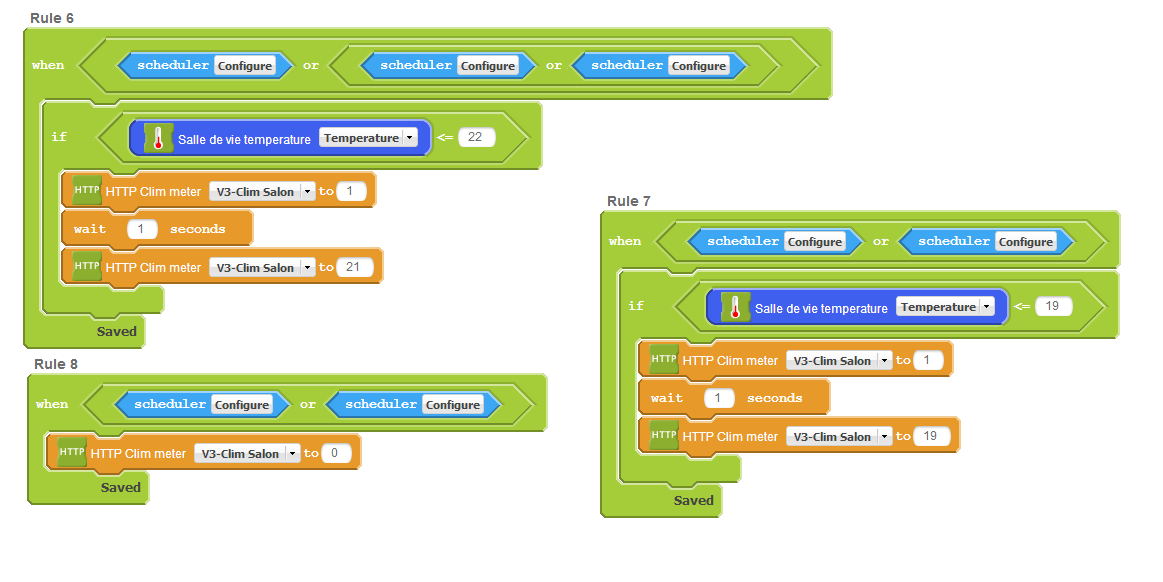

I prefer use rules with my AC and ZXT.
With Climate you can't start or stop AC.
I made rules to start,stop and set temperature with my phone.
I use Scheduler in rules to start and stop AC according temperature.

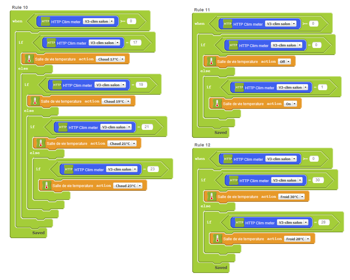

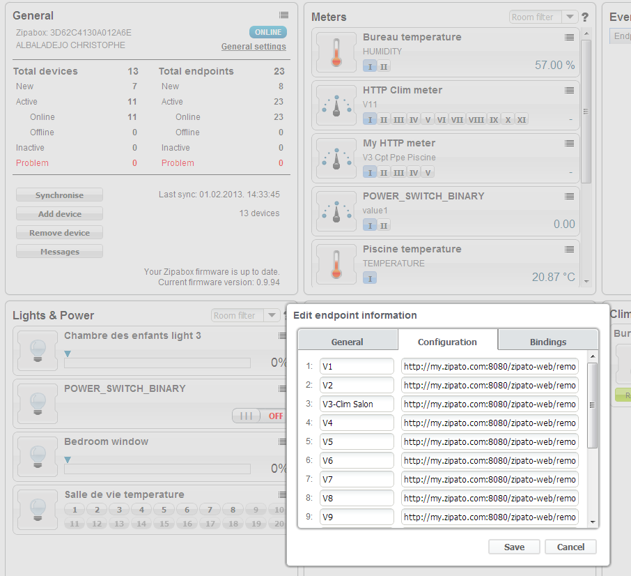

I made a HTTP virtual device for my AC (one for the moment,7 in the futur)
I made rules with scheduler to start and stop according temperature (rules 6,7,8)
I made rules to "action" ZXT from HTTP values. (Rules 10,11,12)
I have create on my phone shortcuts to Start, Stop and change temperature with HTTP meter.
I don't use "action" directly in rules 6,7,8 because i don't know why, the ZXT send "on", "off", "temperature" betwen 3 and 20 times to AC.(beep, beep, beep,...)
I use Climate for my radiator (on, off), but not for AC.

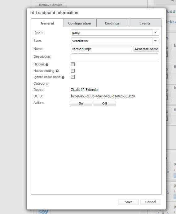

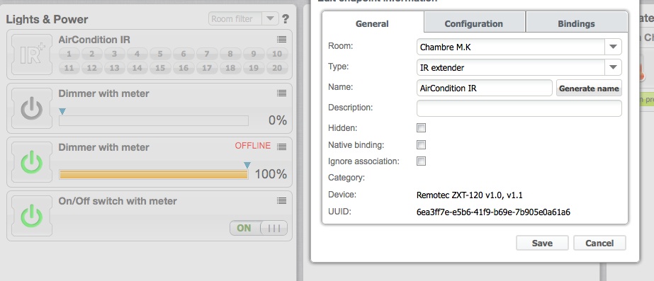

Hello everybody,
I have managed to join the RXT-120 with the new zipabox but....
I still cannot see the "IR CODE NUMBER" in order to connect the zxt with the air con.
I've added some pics so that you can see what it looks like.
I've removed and added the zxt 3 times. Is there something else i should do ?
Thanks,
Erik

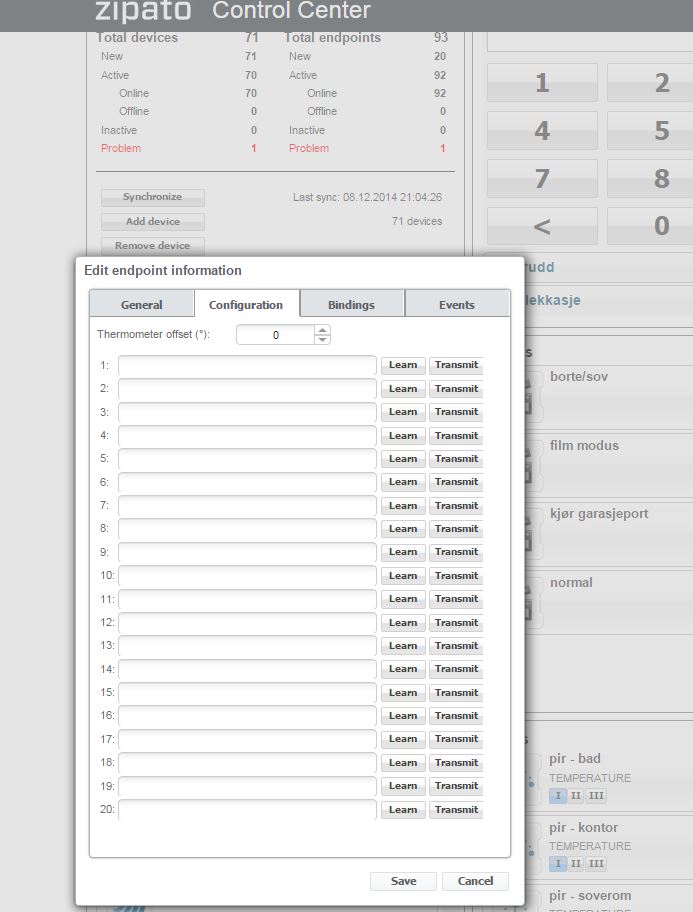

How in the configuration dialog box for entering the codes manually? I do not understand how to get the on / off and other codes.
Thank you for helping me.
I just ask for help on this module because I dry miserably.

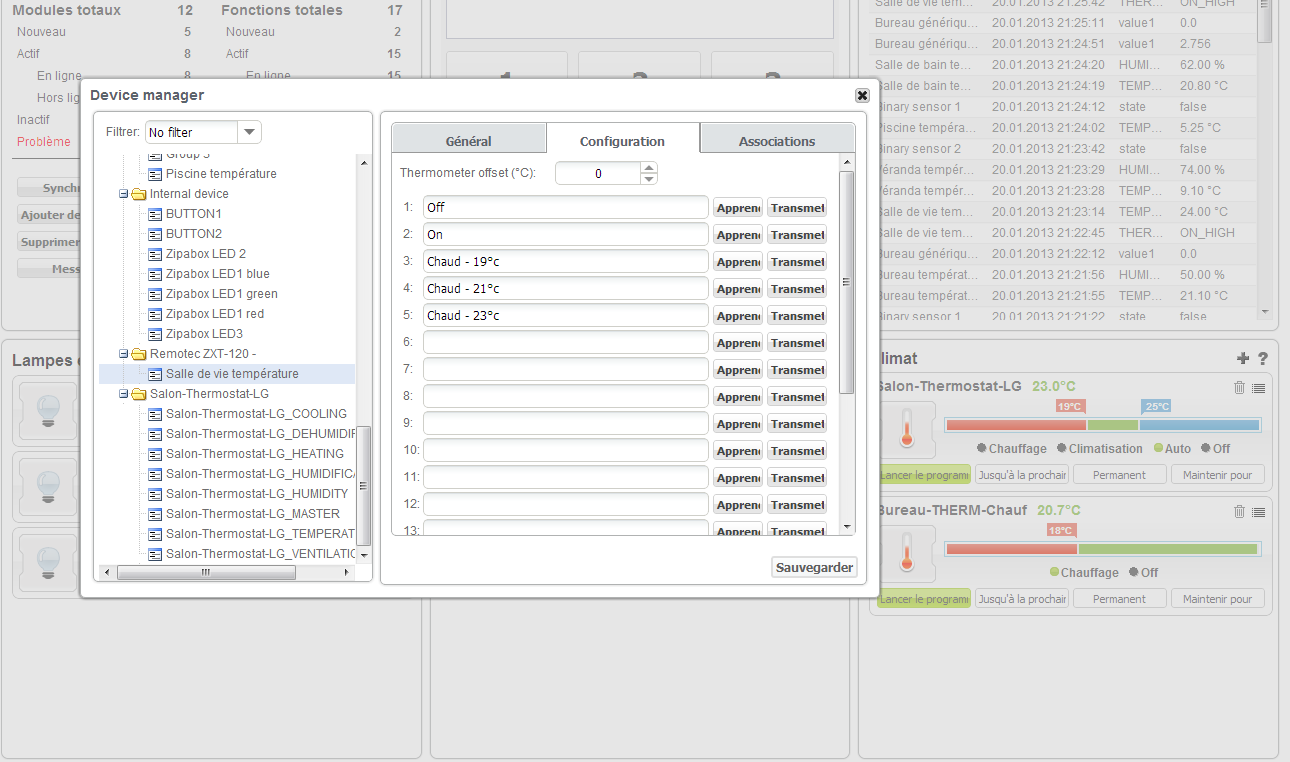

I don't understand how to learn the codes manually with zipabox.
In the box configuration of the module, we have several fields to learn the codes from the remote control.
But how ? I have no same doc in zipato on this box configuration.
How to use the two buttons "Learning" and "send" ?My air conditioning is a mitsubishi electric codes but I try (supposed to set the module fully aircon) causes a beep to my air conditioning (and therefore get a good info of REMOTEC) but suddenly my aircon not breath, he must I use my remote control to restart the blower, I wonder what happens.Thank you in advance to those who mastered the subject

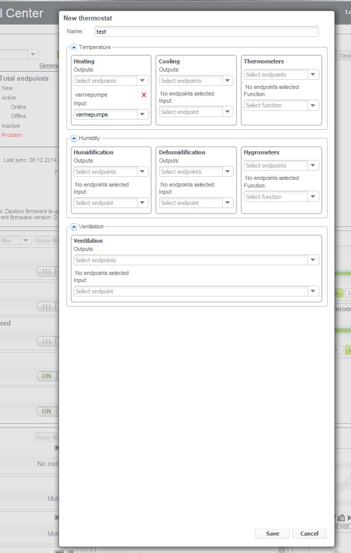

i have remotec V1.6H, and want to use the climate widget.
i cannot find where to write the IR code from the Code List with the ZXT-120 for my Panasonic Airconditioner. The Learn/Transmitt works well, and rules for that.
Have tried powecycle zipabox, zxt-120. Factory reset, switching between FLIR/Always listening..
