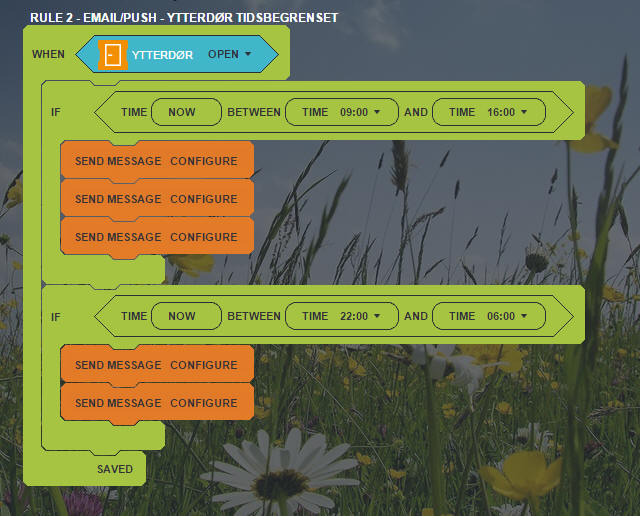

Restrict rule to weekdays ?
Reidar Østrem shared this question 11 years ago

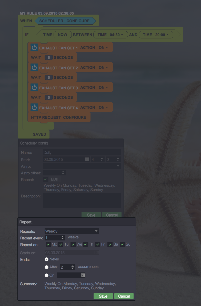

Is it possible to create the attached rule only to trigger on weekdays ?
I see there are a variable "day of week" but will i then need to define each day in the rule ?
Thanks for the help.
Reidar

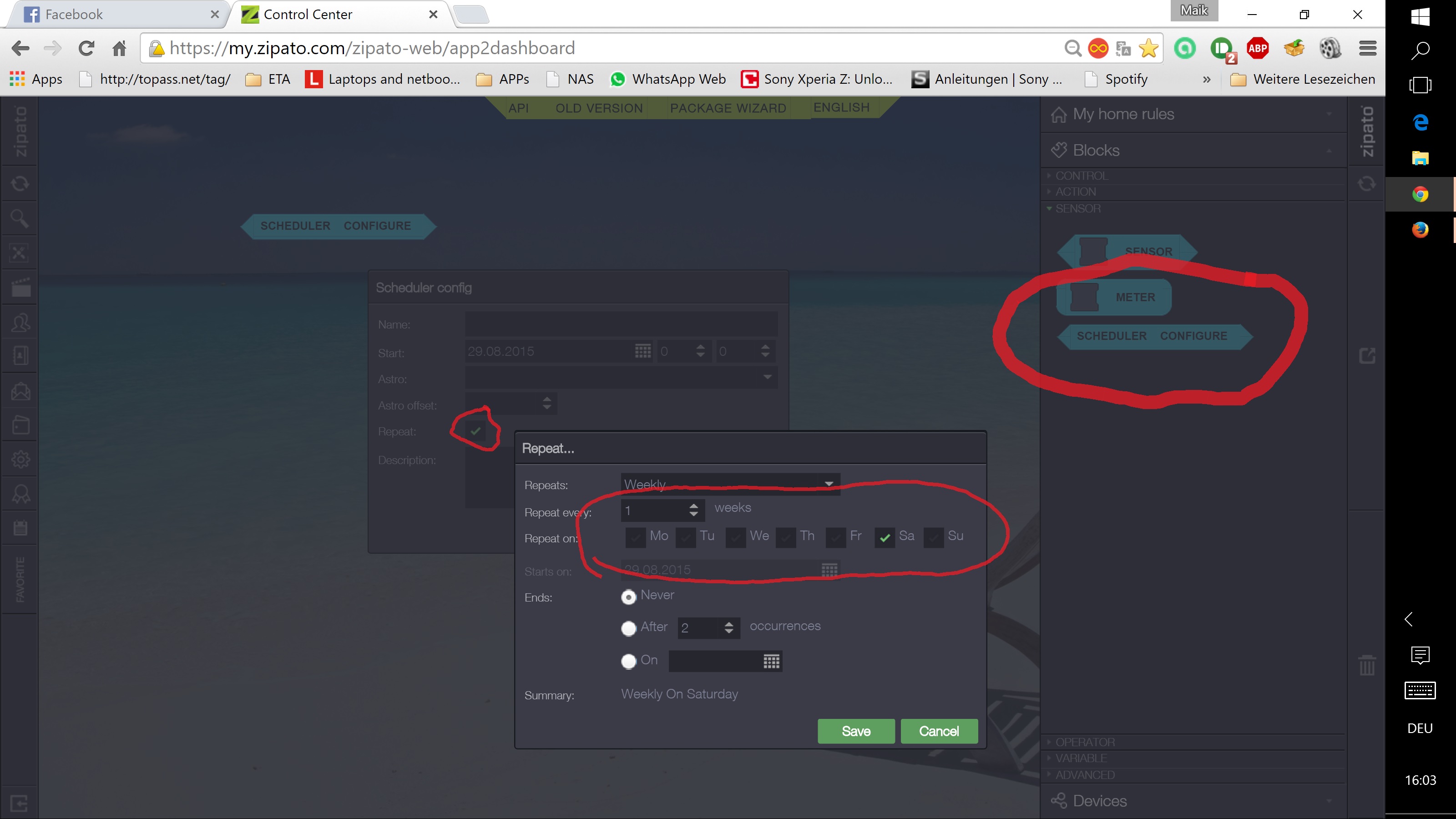

Hello
Use the Scheduler for this.
regards Maik
Hmm.. tried the scheduler but maybe i did it wrong....
Any ideas why the attached is not working ?

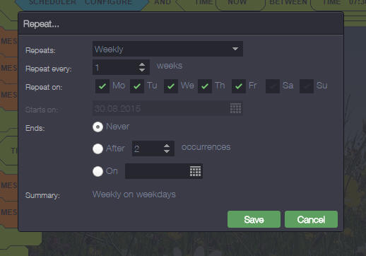

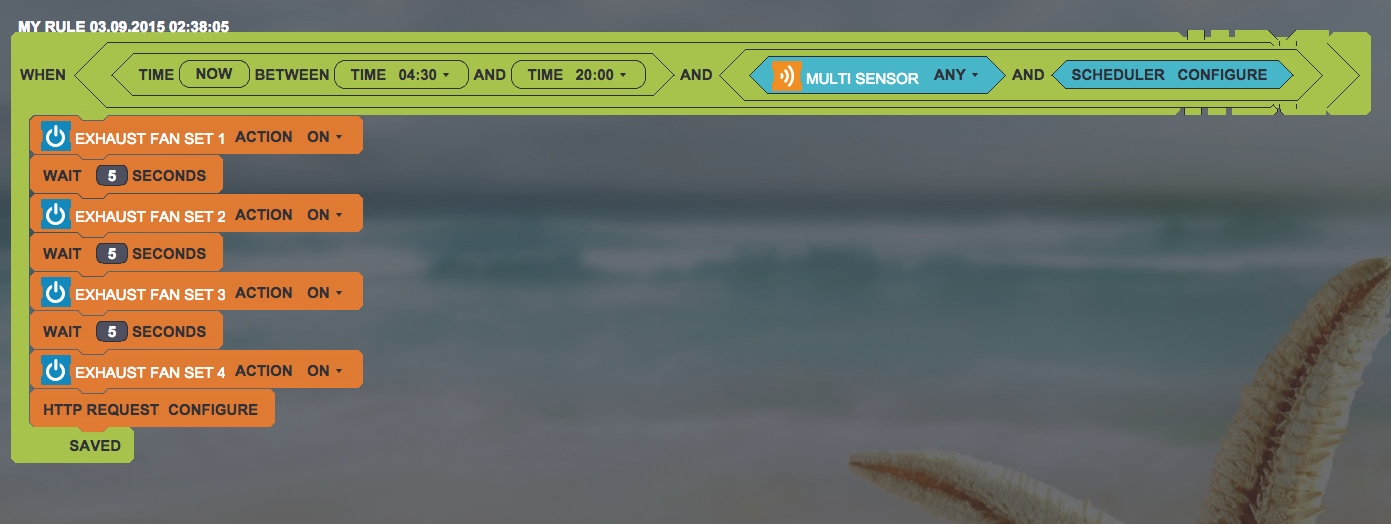

Try something like this.

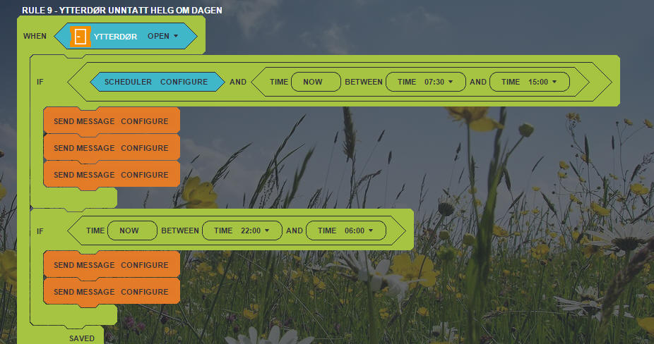

Hi Maik,
Adding the scheduler with the sensor did the trick i think.
Thank you for the input! :)
Reidar

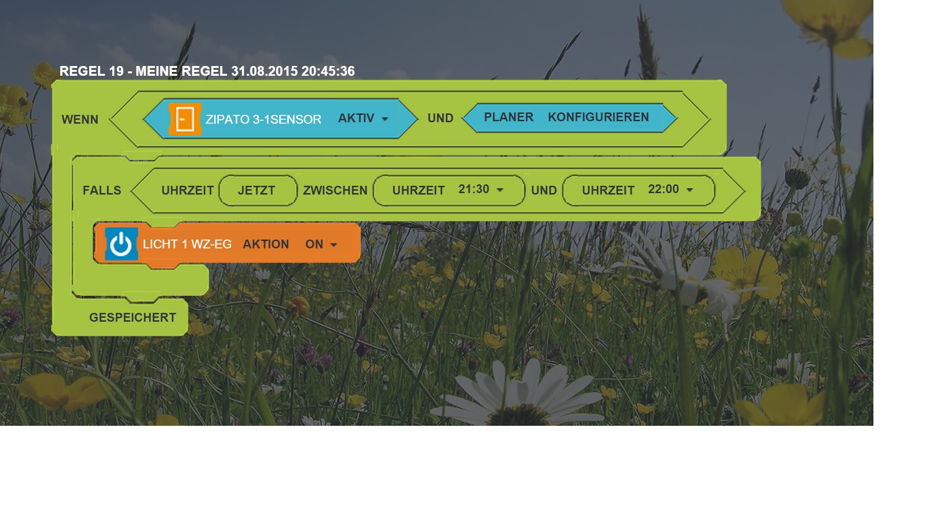

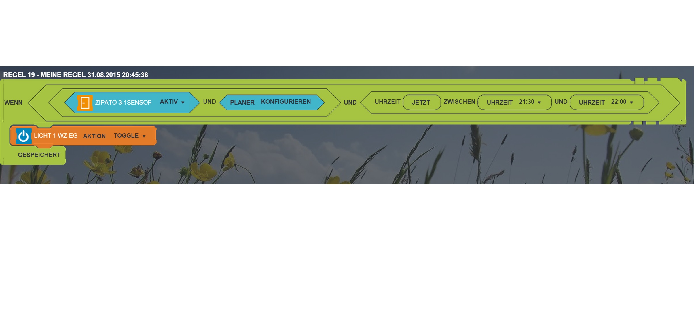

Hi guys, I am also trying to set a simple daily schedule, but somehow it is not working, can someone explains why? I followed HeroS's link but why does it requires an location to work?
Try without the between you don't need it.
And test with an e-mail
Also tried adding a sensor, but no luck so far.

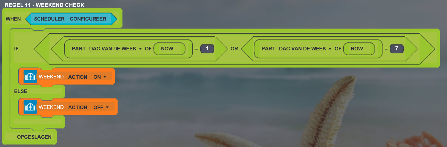

I have a somewhat other approach.
Because I have different rules that only may fire in the weekend OR on weekdays I have created a weekend check rule that will flip a virtual switch and use that virtual switch in my conditions for various rules. That way you only have to configure it once and your other rules stay "clean" and "simple" :)
The rule runs through the scheduler everyday at 00:01 and flips the switch when it's day 1 or 7.
