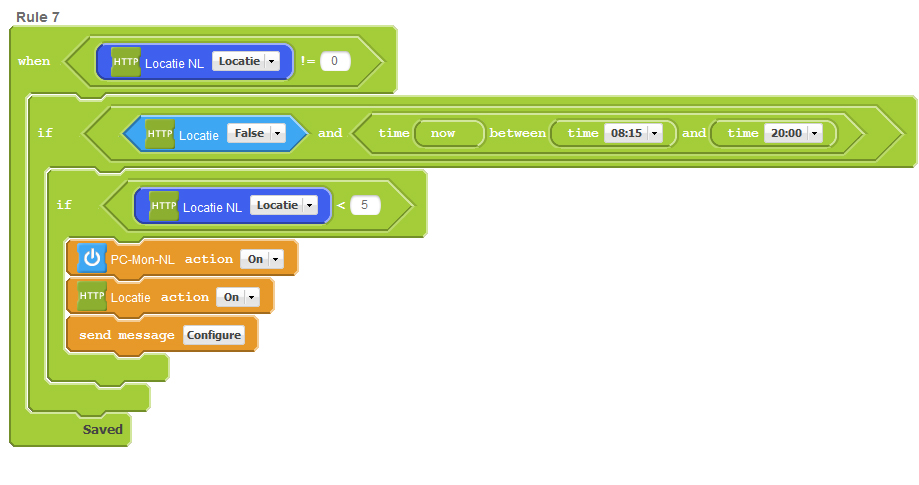

How do i make a rule with between time in it run only on Sat/Sun?
Thanks!
Replies (7)
What would you use as event trigger? Please write some example what you would like to do with this rule.
Thanks for the respons. Here is the rule (is to trigger my location)
I want this rule only to work on Sat/Sun

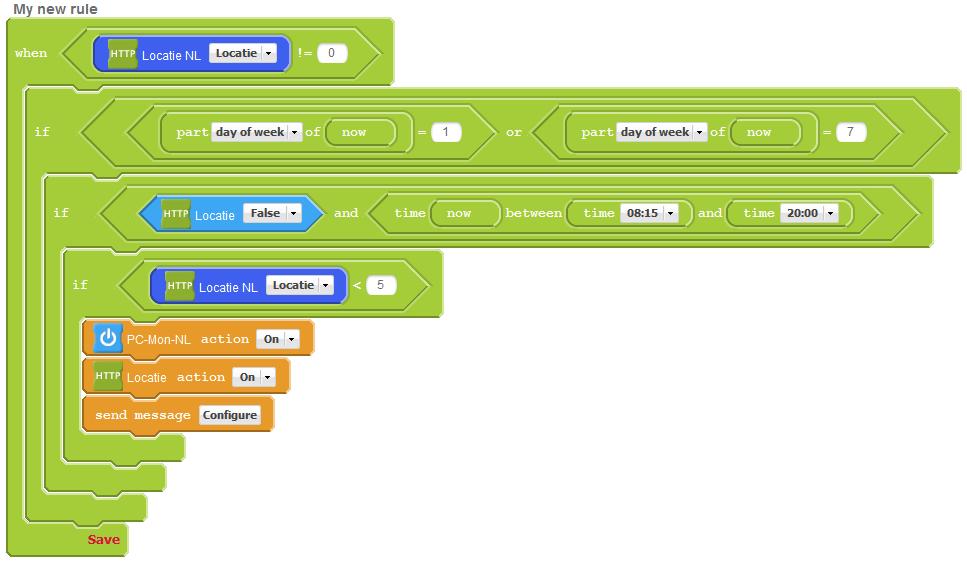

Anyway, it is possible to run the rule only on specific day of the week. See attachment.
Oke great! thanks
1=saturday and 7 sunday?
Hi Sunday is 1 and Saturday is 7
