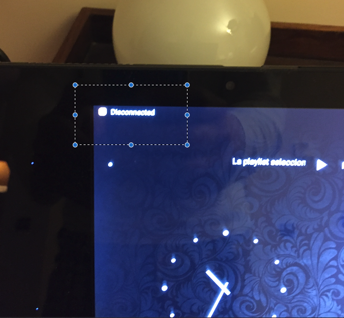

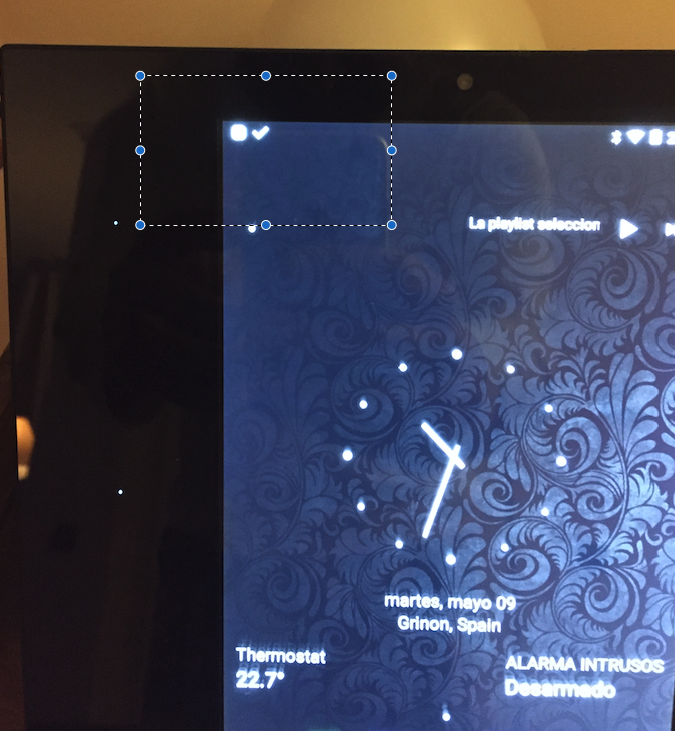

I installed the new OTA.
I have a problem, every 2 minutes or so, in the upper left part of the screen, a message appears with a symbol that says "disconnected" then returns the symbol of "V"
Any ideas ?? Attached images.
Also every 5 minutes turns on and off the screen.
Greetings and thank you.
What OTA version did you install? V1.0.6. or V1.0.7?
What you describe was introduced with V1.0.6 (continuous disconnecting of "intercom"). If you installed OTA V1.0.7 then I guess this is not fixed yet (and will my current download of OTA V1.0.7 be another frustrating experience).

I downloaded and updated the latest OTA available today, V1.0.7 in my case it follows exactly the same as with version V1.0.6 that gave the same problems.

New version of InterCom application which resolves "Disconnect" issue will be available today via AppRepo.
