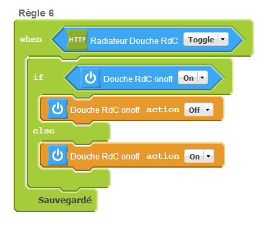

I'm using a Fibaro Module FGS 211 to command a radiator. But On and Off are reversed. If I put to ON in Zipabox dashboard or Mobile, the radiator get OFF and vice versa.
I think create a virtual switch and a rule but it doesn't work (see attachment). I'm absolutely not a developper, I assume my logic is not... logic.
Could you help my for:
- the rule?
- change parameters to reverse ON and OFF?
Thank you.

Hello Fred,
No, I followed this article (http://www.planete-domotique.com/blog/2012/01/05/piloter-un-radiateur-grace-a-son-fil-pilote/) and it 's seems normal ("...You should know that your heater will work if the module is OFF and not ON...")
Is there somethink wrong ?
