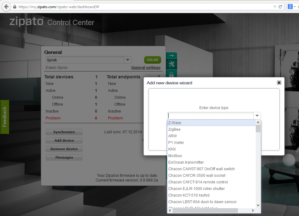

When i start adding devices i get a list of devices that i can add.
I read somewhere that i can use zigbee, but that doesn't work.
The controller gives the messages "You don't have selected network!"
Regards,
Edwin.
